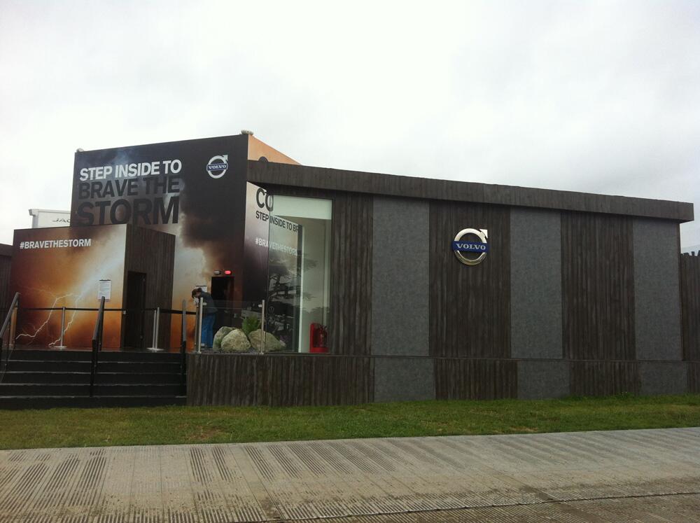

The Volvo stand at the 2014 Festival of Speed.
Simulated storm in a 6 x 6m room with rain, sound and lighting. The rain sequencing and switching it off where people were standing, was controlled by 73 off PIC16F506 running code compiled on Oshonsoft.
All designed, manufactured and coded in three weeks. The code was 100% reliable and the customers delighted.
