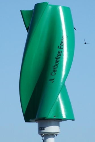

Hi everyone.. Thank you so much for your feedback and suggestions. I'm appreciate it.
Actually, I'm doing my project based on the previous student who had design the MICRO - SAVONIUS VERTICAL AXIS WIND TURBINE (VAWT).
She do a research on the SAVONIUS WIND TURBINE PERFORMANCES ON WIND CONCENTRATOR.
And for my project, I wants to improve her project since her research studies’ design, there is no support in terms of power electronic part to enhance the power output. I decided to use a boost converter to increase the power output.
The attach file is my previous student's project.
And in section 3.4 of that report we have the following vital piece of information:
So, is the "motor" a permanent magnet DC motor, or is it a brushless DC motor?
It makes a big difference.
One will work well if driven at a suitable speed, the other one will not produce much at all.

Hello NI,
Can I just explain one thing: a boost converter cannot boost power. This may sound pedantic but it is fundamentally important: a boost converter only boosts voltage and, at the same time, reduces the amount of available output current in the process. Furthermore, the boost converter wastes power in the process and typically this loss would be in the range 10% to 30% depending on many factors.
Take an example.
You wish to convert a power source of 1.5V (typical AA battery voltage) to 5V to power some 74 series logic chips.
The 1.5V supply might have a maximum current of 100mA. Thus:
Input power = 1.5V * 100mA= 150mW
Assume a boost converter efficiency of 80%, thus the output power would be 0.8 * 150mW= 120mW.
As you want an output voltage of 5V, the maximum output current would be 120mA/5 =24mA.
Incidentally, the missing 20% of power would be dissipated by the boost converter as heat.

Hi NI,
I have just read the attached report and very interesting and informative it is. I now know what a Savonius wind turbine looks like.
But, like JimB, I find section 3.4 erroneous. Quite simply, it is not to the same standard as the rest of the report:
3.4 DC Motor
'DC motor is a device that can convert mechanical energy to electrical energy. Mechanical energy
comes from the rotation of the rotor which is connected to the shaft of the DC motor and the
electricity produced will be connected to the load from the output terminal as shown in Figure 3.3.
Furthermore, in order to produce high reliability and high efficiency of small wind turbine, the
preferred choice of motor is the brushless DC motor as shown in Figure 3.4.'
To be technically correct, the opening sentence should read:
'A DC motor is an electro mechanical device that converts DC electrical energy into mechanical energy. Under certain circumstances a motor can be used for the reverse function.'
But a motor is not applicable to this application, so the opening sentance of section 3.4 should read:
'A DC generator is an electro mechanical device that converts mechanical energy into DC electrical energy. In some circumstances a DC motor can be used as a DC generator'
Then there is JimB's point about DC brushless motors being unsuitable for use as DC generators.
I know it is probably not in your remit, but you really should bring these points to the attention of your tutor because they throw the credibility of the whole report into question.
Also, because of this, you are being given an almost impossible task which bears no resemblance to the main object of the exercise, which is to assess the feasibility of wind turbines for Malaysia. By the way, I lived in Kuala Lumpur for a while, and apart from the monsoon season, it was practically windless.

The wind speed in Malaysia seems to be almost zero. In my part of Canada there are many huge lakes that have very strong winds blowing across them. Boats use fan propellers and vertical spinning things driving generators to charge their batteries. The windmills spin like crazy and produce at least ten thousand times the power of this project. The windmills are about the same size as the one in this project.
