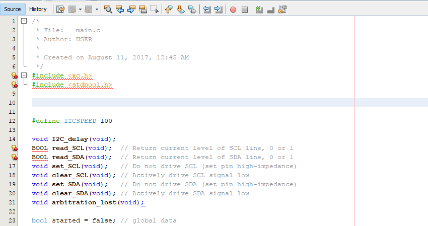

I tried that it saying it can't find the .h file include <stdbool.h>

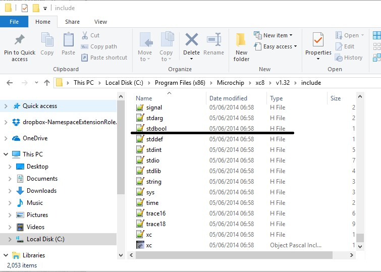

Well it's definitely in the include directory... I just check V1.32, V1.33 and V1.41.. All three have the file..
Ian I no it's in there when I try to use it I get error that it can't be found.

Which I did
#include "xc.h"
#include "stdbool.h"
#include "GenericTypeDefs.h"
#include "boolType.h"
#define I2CSPEED 100
void I2C_delay(void);
BOOL read_SCL(void);  // Return current level of SCL line, 0 or 1
BOOL read_SDA(void);  // Return current level of SDA line, 0 or 1
void set_SCL(void);   // Do not drive SCL (set pin high-impedance)
void clear_SCL(void); // Actively drive SCL signal low
void set_SDA(void);   // Do not drive SDA (set pin high-impedance)
void clear_SDA(void); // Actively drive SDA signal low
void arbitration_lost(void);
I get a bucket load of these
C:/Users/USER/Desktop/Clearning/bitbang/bitbang.X/main.c:81: warning: (374) missing basic type; int assumed
I can change to a .cpp C++ and I can use them.
But bool is being used a type of int to just check if I'm getting a 0 or 1 bit for ack on the scl line .
I found this code from microchip sample and some reason mplab x 3.65 or 4.00 dosen't like bool at all.

Quotes "" are for working directory and triangular braces <> are for the compiler directory..
I Be leave you but It still not right I did it both ways " " and < > get the same bull it can't even find xc.h

I think I figured why
#include <xc.h>
#include <stdbool.h>
Was not working I was using the plib and to get that to work I had to point to where they where
Then when I went to play with this i2c code it's still pointing to plib folder.
So now it cant find the files as it should I reset the compiler path and what not back to default and it's using it now.
