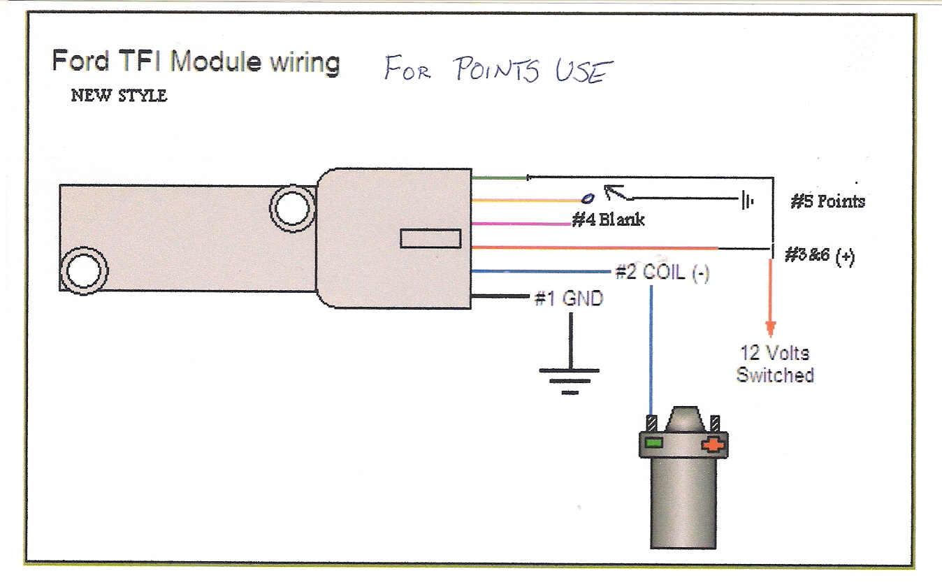

The pointless ignition system is for magneto type ignition systems. Not 12v coil & points systems.
This is a Bosch/ Ford Ign module beter suited to points conversion. Its main feature is if the points are closed & ign is on it automaticly reduces current draw. This is one of the draw back of the HEI module. Cant remember where I found this circuit. The module does need to be mounted on a heat sink & the heat sink also needs to be connected to the neg supply.

High everybody,
Thanks for your help, I have been trying different ideas out over the past few days and i have ran into another roadblock. i bought a Ford TFI module in an attempt to just get this to work. and it ran for about 30 seconds and then i lost spark. i believe it has something to do with the module as when i check to see if i have continuance when i take the wire to ground and then off (simulating the points) i see an open circuit then ALOT of resistance. however when i flip the power off then on again and try the same test the module powers the coil on and off just fine for a short time.
I know you guys will point out the heat sink first thing but honestly im holding my hand on the back part and its not that hot, but im willing to listen. Also i wrapped the terminal ends with electrical tape so the terminals would not be connected.

OK, not sure what to make of it yet, but take a look here: https://www.hotrodders.com/forum/duraspark-module-overheated-engine-died-225477.html
It does mention the coil/ballast resistor matching. In a normal points vehicle. the 12 V to the coil is powered through a low value resistor that in many cases was mounted on the firewall. Just during starting, that resistor was bypassed.
There is also an interesting construction technique as well.
EDIT: There is always the possibility that what you are doing causes the module to go into protect which requires a power recycle to fix.
What coil are you using? A coil for the old points type ignition is not the same as the electronic ignition. The ohms/resistance is different, that may be what is smoking the drivers.
That's what I said essentially. At the very least, you have to keep the ballast resistor designed for the coil.
"Start(Ignition switch)" connects to the coil directly and "IGN(Ignition switch)" connects to the coil via the ballast resistor.
That's the way a Kettering style works. Electronic ignitions like the GM module and Ford don't use a ballast resistor. A direct 12V connection. The electronic ignition uses a low resistance coil when compared to the Kettering type. The higher resistance kept the points 'wiped' and except during starting operated at 6 - 8V. To keep the coil from overheating. The electronic modules also don't like to be run open circuit, with no plug in the leads.
