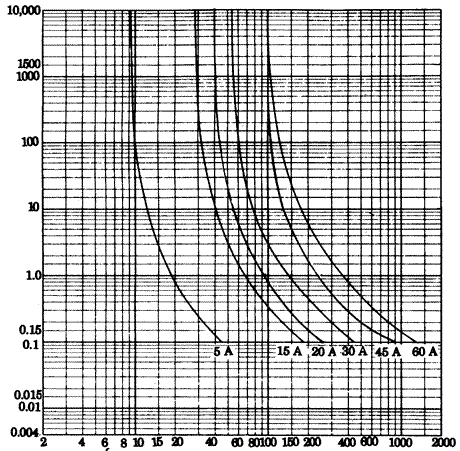

Can't you find a smaller fuse to blow? There must be many smaller fuses that would stop the car. If you have to blow an 80 A fuse, then 100A is nowhere near enough. If you look at https://www.tlc-direct.co.uk/Figures/3.13b.gif you will see that you need somewhere near 500 A to blow and 80 A fuse in 1 second, and the 12A thyristor is only rated to 100A for 1/120 seconds.
Also, you don't know how big the current is going to be, so you need to allow for higher currents or longer times. To take out an 80A fuse you need a seriously large thyristor.
