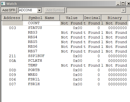

    Working on a program that was working prior to an MPLab fail. Now program will not build and lots of #113 (Symbol no previously defined) and #126 (Argument out of range ) errors.
    Language: MPASM
    Assembler: MPLab 8.92
    MCU: PIC16F1829 @ 5V
    Programmer: ICD3
    Sequence of events:
    Project involves controlling the AS3935 lightning detector. I typically work with a single project folder. As I develop various versions of the program, they go in the same project folder and are added or removed from the project tree as needed. When changing the active/working .asm file, I go to build options and disable case sensitivity. This particular project now has about 6 versions of the assembly file.
    Each program version has the same set of macros. They include a delay macro and stack-based print macro from Mike -- K8LH. There are a couple of other macros that I wrote. The macros work in every version of this program.
    As I was doing hardware debugging of the current program MPLab stopped and gave an message that source code had changed and gave me the option of "rebuilding now." Source code hadn't changed, but I agreed to the rebuild. All hell then broke loose.
    Cannot get the program to build. There are a slew of #113 and #126 errors. All of which point to calls from the macros.
    The Watch window is a complete mess:
    Those missing registers are all defined:
    Code (MPASM):

    What I have tried:
    1) Turned everything off, disconnected, exited and reopened MPLab a few times. Same result.
    2) Removed current version of program from the project tree and re-installed most recent previous version. Version has same macros . That version built fine. Reversed that process and re-installed current version -- still fails.
    3) Tried going to release mode and programmer. Still doesn't work.
    Assumption:
    MPLab acts as if it has inserted some flag or block that is preventing it from loading/reading the entire code. Is there any way to look at what it may have done and forcibly make it read the whole code?
    John

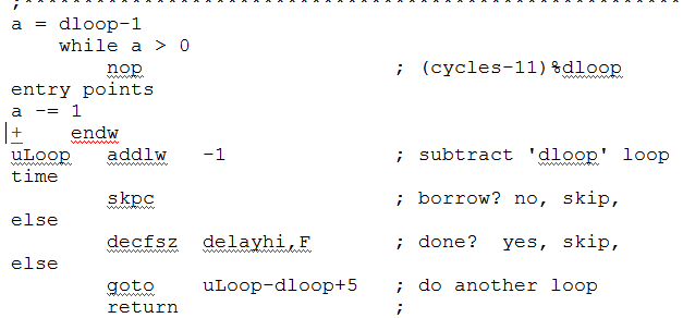

    Success
    Deleting MPLab files and a lot of other failed tries didn't work. Of course, the errors were a bit too cryptic to help, and I am too damn dyslexic to recognize correctly every character in a statement.
    After whittling the "failed" program down to its bare essentials, I noticed something in the delay subroutine:
    I don't have a clue how it got there, but that was the issue. I did not consciously mess with any of my regular routines. No more two pages of errors. Original compiles just fine . Conclusion: "+" is not always better.:)

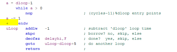

    When we installed new software in our labs, IT could do a character by character comparison of results (many thousands) to find errors. Is there anyway to do that within MPLab or in a text file using Office or other software?
    EDIT: As much as I hate Word, it does have a document compare, and it was able to find the error in a test:
    Didn't even have to change the extension from .asm to a more conventional text extension.

    Ouch! Man, my cat has done that to me before (added a character to a source file). Unfortunately, that extra character you finally found doesn't really look out-of-place in that rather cryptic macro code (sorry)...
    Happy to hear you found it and got it working again.
