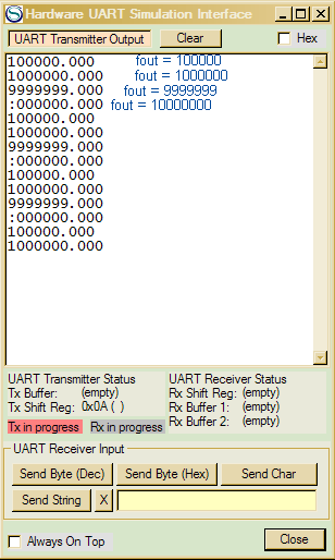

I am also finding limitations with the FP Single.
The manual states that if you prefix a Single with the hash sign '#' it will be available for Uart or LCD as a decimal value ASCII character string.
I have added Hseropen etc, and then displayed the #fout string, above a certain value the upper characters become corrupted.
I will try to determine what the limits of the Single are, will post later.
Eric
This is a sample of the results so far.
Using Hser suggests that #fout SINGLE value has a maximum of 9, 999,999
I will run comparative tests on the Watch window values.
nxt1:
fout = 100000
Hserout #fout, CrLf
fout = 1000000
Hserout #fout, CrLf
fout = 9999999
Hserout #fout, CrLf
fout = 10000000
Hserout #fout, CrLf
Goto nxt1
