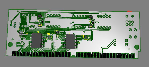

I've finished my PCB design- so off to the fabricators and then a wee wait- and I'll be laughing.
I'll post back when its done to let you all see it.

Sorry for the late reply but it seems you've received all the correct answers from the gang.
Say, how 'bout showing us a BMP or JPG screenshot of your layout?

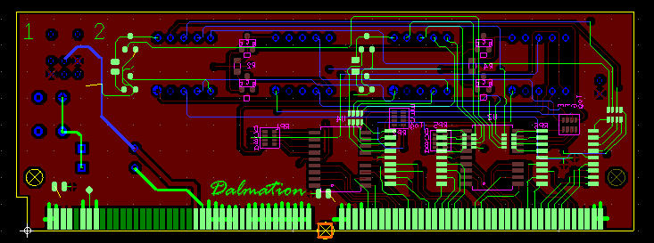

no probs- I'll post a pic when the missus lets me back on the laptop. I'll warn in advance, though- its a very busy design!
I have a powerplane on both sides of the board and 1 on the middle layers (4 layer board). I'll remove them for clarity.
-Dal.

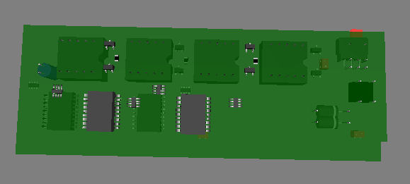

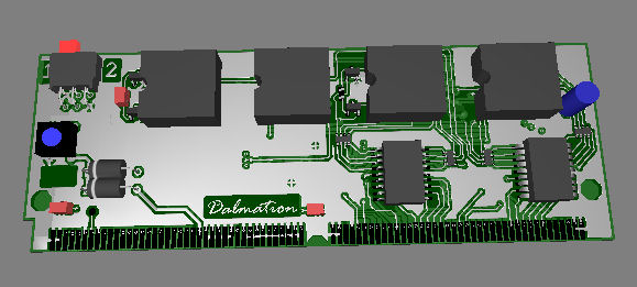

The 3D renders of the hex display isnt exactly wonderful- but you get the idea. Board designed with National Instruments "ultiboard".

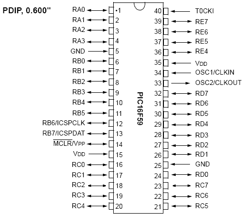

I'm waiting on the PCB's arriving, but in the mean time (for future use) I was having some thoughts...
I currently have 4x 16F628, would it be technically possible to use 2x 16F59 (pinout attached). It has 33 i/o pins. I dont know how the port arrangement affects things.
the 16f59 is really cheap compared to the 628 and I migh be able to get it down to a 2 layer board with the lower component count (half as many IC's, resistors and transistors too).
I know it would be a total reprogram job (and I'm not looking for that), but is it possible?
Let me know your thoughts on the subject.

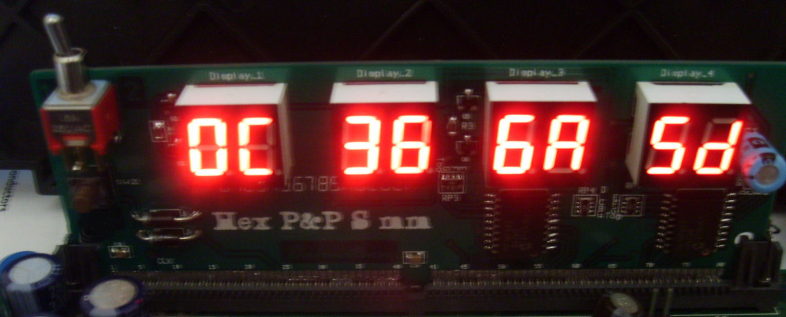

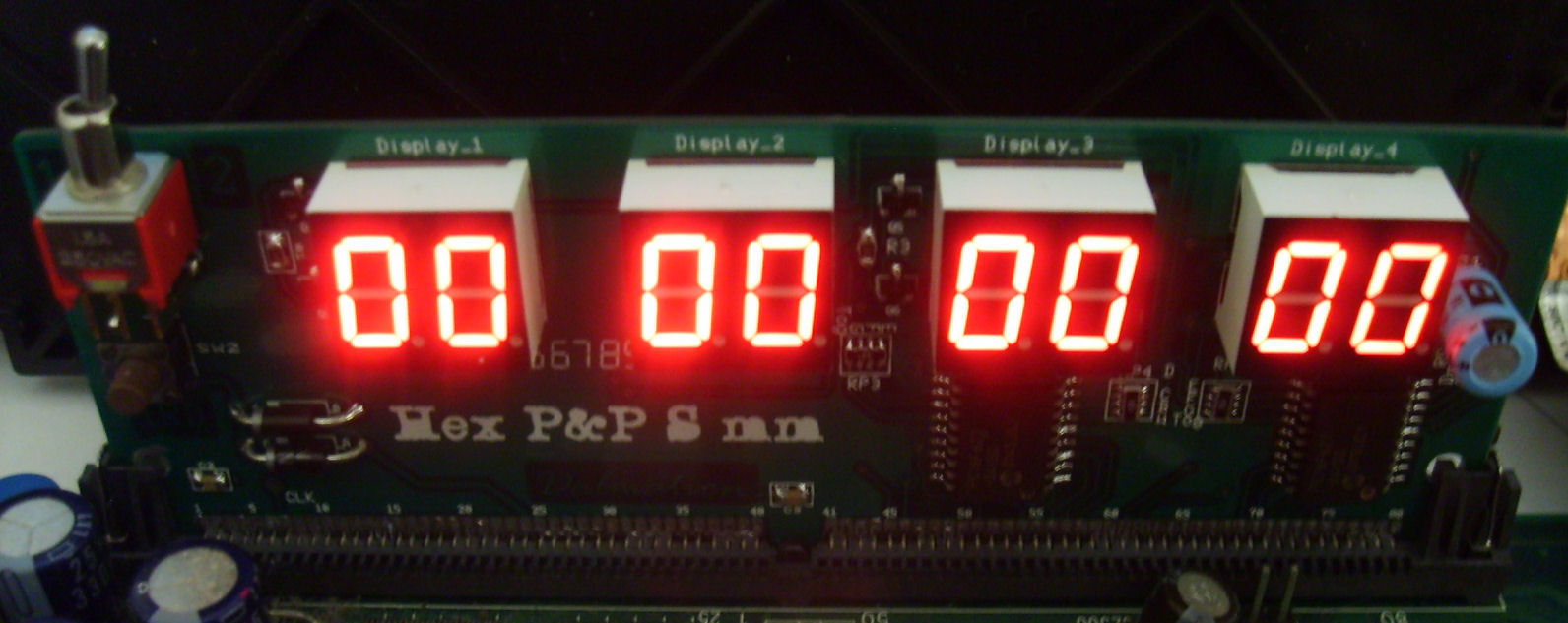

I mentioned that sometimes, something goes wrong and the display reverts to Zeroes.
The reason (ive found) is that the pic inputs are not drawing enough current, and the mother-board believes nothing is connected and puts the eeproms in a sleep state (annoying!!).

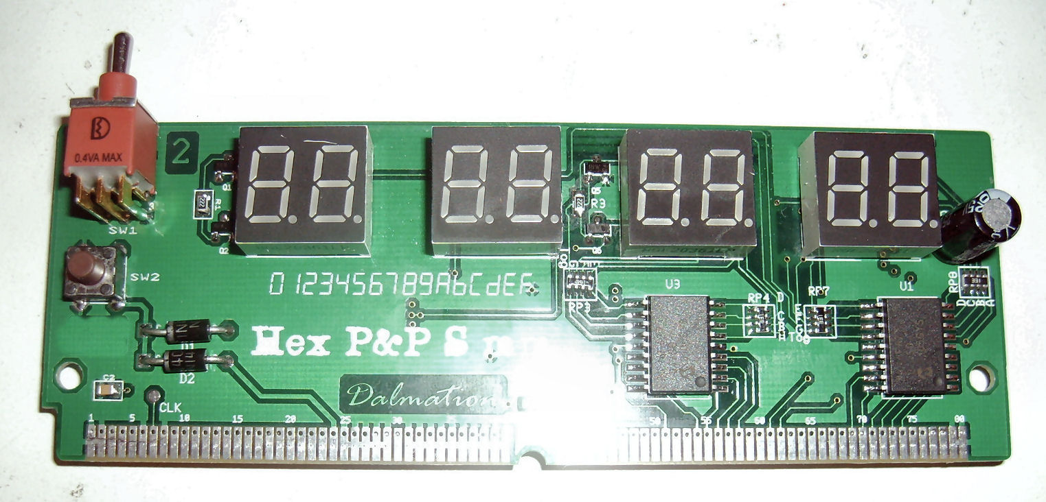

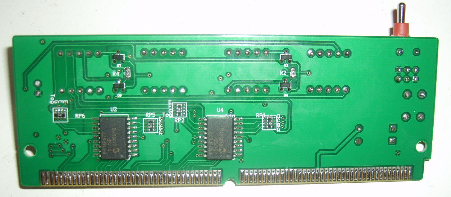

I am looking for a solution- if you look at the pictures of my PCB, theres not much room.

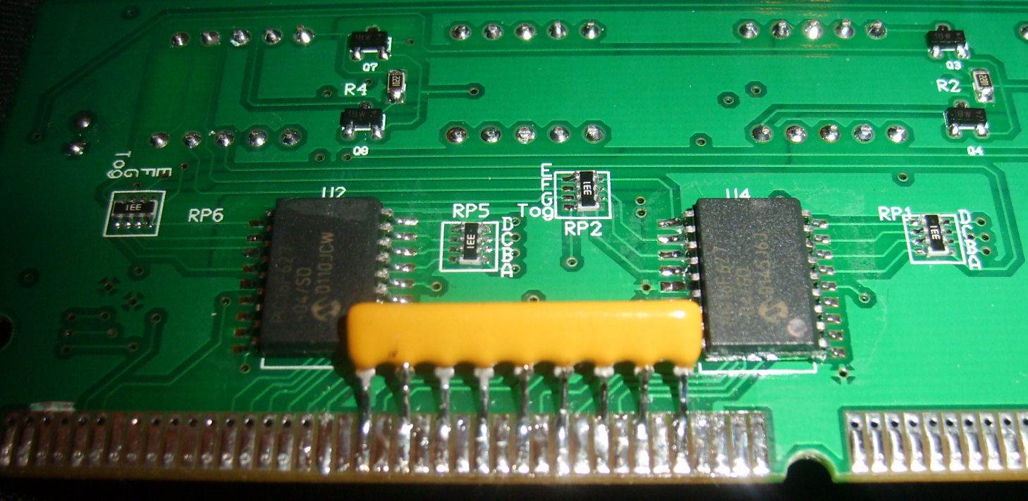

I added a 1K resistor array, pulling some of the input lines to ground. This fixed the problem, but made the display a bit wonky. The eeproms stayed on.

Ive spent all day playing with pull down resistors- I need to add 32 resistors (about 5.6K) to the input lines- but then the display isnt sure exactly what to display. It just isnt practical on such a small board anyways- even with surface mount. I need to draw slightly more current- only a milliamp or 2 would do it
