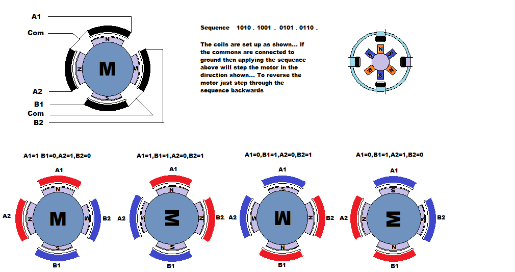

The next tutorial I want to look at a stepping motor... To step a stepper motor we need to sequence the coil windings... The windings are arranged so applying current to the coils in a certain sequence we can turn the motor in small steps.
The sequence shown in the diagram will step the motor in full steps 0AH, 09H, 05H, 06H..

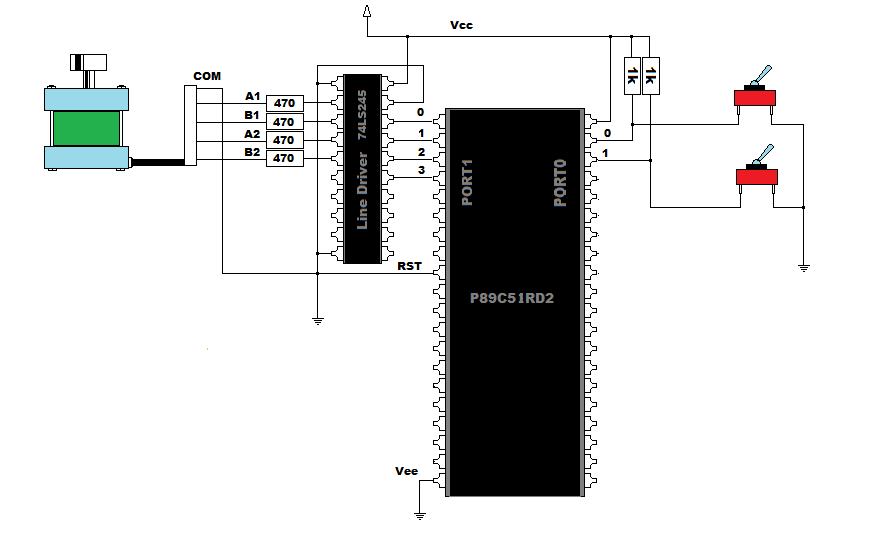

The connections are as follows...
