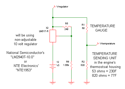

It suddenly occured to me that I never supplied some very pertinant information. Perhaps this schematic of what is already in place (except for the solid state voltage regulator) will be useful. The stock bi-metal voltage "stablizer" that the car has now, provides an average of 10 volts to the voltage divider comprised of the temperature gauge and the temperature sending unit.
I am not trying to control the engine temperature with this fan. The engine's thermostat does that extremely well as long as the car is moving over 5-10 MPH. The cooling system has been modified. It has been tested and can keep the engine at normal operating temperature (180F) on a 100 degree day at or near top speed for over an hour.
It's only when the car is stopped, that I am concerned with.
I want to be able to set the temperature when the electric radiator fan turns on by turning a knob/potentiometer. Ultimately I'd like to be able to adjust when the fan turns off with another knob/potentiometer to within as little as little as 0.1F degree lower than what the turn-on temperature is set to.

Mr Al, I plan on incorporating MOSFET(s) for driving whtever I end up using on the output side - one or two windings or relay or PWM or some combination thereof. I could not find a schematic of a MOSFET switch. I did find a bipolar NPN switch schematic which is what I used. I am "borrowing" pieces of schematics I find online and putting them together to make what I am posting.

MrAl, I believe I understand enough about the nature of digital latching components, now. At least enough to see why it's necessary to use a latch in order to keep the fan running as the temperature drops down below the turn-on point.
After considerable thought, I have changed my mind from my earlier postings and now I believe having an adjustable turn-off that is different than the turn-on may not be needed. I am planning to use a circuit without the independant turn-off feature to see if there are drawbacks.
In other words the fan will turn on at an adjustable setting, say 181 F. The coolant flowing past the sending unit will still be above 181 F, while the fan is running, making the radiator cooler. Once the radiator coolant enters the engine, and the engine cools enough, the coolant flowing past the sending unit will eventually get below 181 and the fan will turn off.
Is keeping the buffer comparator in an on state like this for the entire time the fan is running a bad idea ? Will using a latch in this scenario be necessary to prevent problems with the 339 oveheating/overworked ? Same for 358s if I use them instead ?
In that case a single comparator with an adjustable turn-on point and fixed hysteresis will do the job. Some hysteresis (electrical or thermal) is necessary whatever you decide to do, to prevent the fan chatttering on/off/on .....
The comparator with hysteresis is somewhat like a latch. Keeping it in one state or the other for prolonged periods won't bother it in the slightest.
