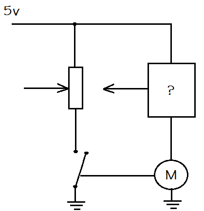

I want the brake pedal to act as a brake still i just want to add a rapid on off inline so the wheels don't lock up if the pedal is pressed real hard. so its like a electronic ABS.

It needs to be on the pedals and i think they use potentiometers reading a resistance value to determine the pedal position. interesting though tho about programing each button, i wonder if it would work using software then.

Right!.. For starters, this isn't a bog standard game pad... The pedals connect to the pad through a wiring loom.
A simple 555 timer could be used to generate the ABS affect, but we would need to know what resources are available.. Have we a ground and power rail, or are the pedals just negatively / positively switched or have you + v and -v on a pot!!
If you said what control pad you have it would make it easier for people to help...

The controller is a g25 ffb wheel and here are the specs i found for the pedal pots.
Potentiometers, Variable Resistors
Family Rotary - Linear
Resistance 10.0KΩ
Power (Watts) 0.5W, 1/2W
Resistive Material Carbon
Rotation 300°
Package 23.83mm x 11.51mm
The g25 has its own power supply and also has a USB that needs to plug into a pc etc.. and the pedals plug into the wheel.

you are best to hack a controller with a POT or analog dial in it already, then the controller has driver already too, as soon as you talk about new controls you are talking about new drivers and instruction sets, im not sure, but fear pulsing may get choppy
so yes, its more complicated than that, also i dont think the guy in video made that foot pedal, those pedals come with the wheel, i think what he did do was added that little spinning thing in the middle:
easiest to go just spend the 100$
what you could also do is if you have access to the footpedals and scope you could trace signal going in to the wheel, then you could spin your circuit off that, cos we dont know if pedals sends analog signal, or analog signal encrypted in digital words

The "spinnything" can be a motorised pot... a micro switch connected to a small 5v motor... The little weight must pulse the signal... Something like this..
The circuitry for switching the motor on will be a simple comparator that monitors the pedal..

Is the foot pedal an analogue signal or a button press??
If it is just a button you could just place an astable ( 555 ) timer in the place of the button..
If it is an analogue output, then you would need a 555, a transistor, a relay, a comparator and a few resistors..
I suspect its just a button!!
