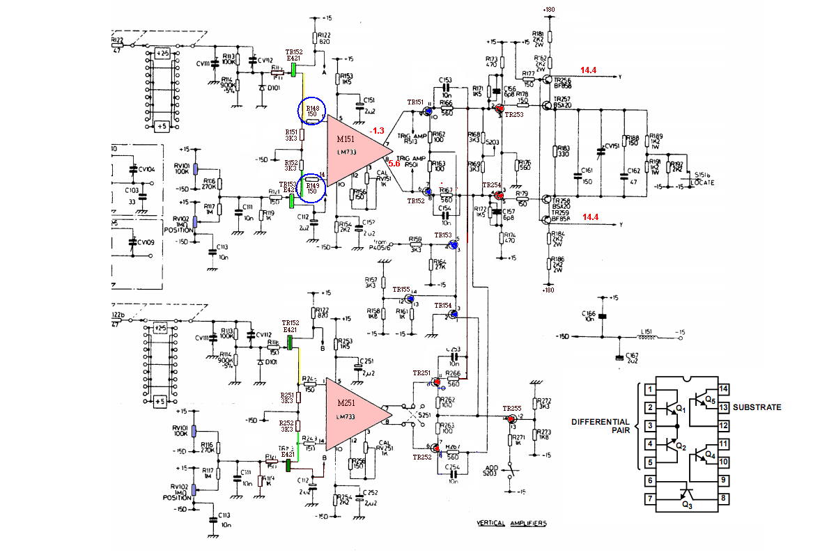

Hi Eric,
Results as follows:-
1 = -1v3
2 = +5v6
3 = +15v1
4 = +15v1
5 = +15v1
6 = +180v
7 = +180v
8 = +14v4 measured on collector
9 = +14v4 measured on collector
10 = -15v1 one end 0v other end
10a = 15v1 both ends
I am not an expert by any means, but I have noticed that one of the +15v1 seems to be -15v1 on the drawing is this an error or a fault on board?
Hoping these will help solve my problem...........Al :)

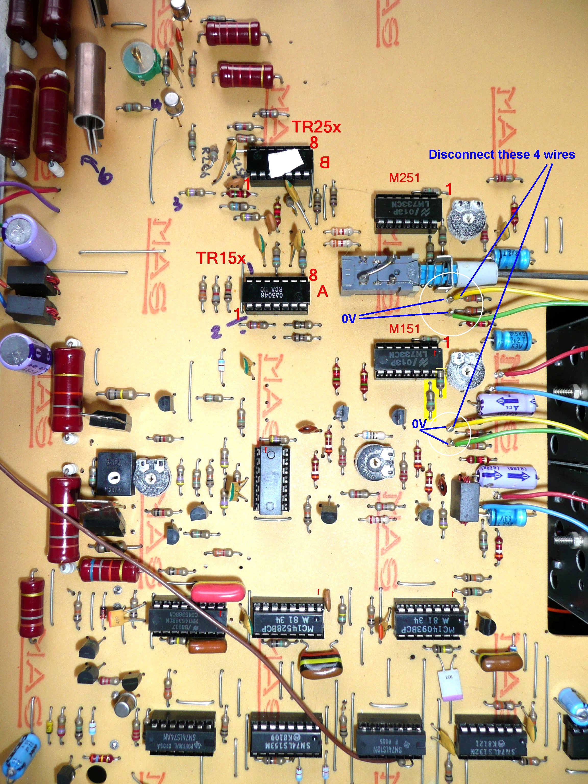

hi Al.
The M151 [733] looks right out of balance.
If you measure on M251 pins 7 and 8 they should both be about the same voltage.
From the ends of the R148 and R149 [150R] reistors are a Yellow and Green wires.
Remove these two wires from the pins [make sure they cant touch anywhere]
The two pins where the wires came off, connect together and ground to 0V.
This will make the inputs to the M151 amp at the same potential and the voltages on pins 7 and 8 should be the same.
Its all pointing towards a duff TR152 [fet].
Look at my attached dwgs and add the NEW voltages measured at pins 7 and 8.
Lets know what you find.:)

Hi Eric,
On the drawing you just posted the TR152 and TR153 seem to be duplicated lower down, well I nthink it says TR153 its a bit blurred, but there are definately 2 TR152s shown on the drawing!
This is baffling me as there is only one FET granted its a dual one but the drawing shows 4 connections to what I can only assume is 1 dual FET, how does this work? Is mine missing a dual fet?
Is it worth me listing my FETs to see if any will do as subs?
Al:confused:

I'll have a closer look at the photo's.
Have you had chance to remove the pair of wires from the 'top' 733 [M151] and ground the two pins to 0V.
Just do it for the top amp at the moment.

Hi eric,
Was just about to do it, do you mean the top 2 wires in the photo you sent?
Al
Hi eric,
Al
The top amp in the schematic M151.
Its the bottom pair in the photo.
The FET area is not the same as the dwg.
The component values are also different to the schematic.
Is there any writing on the EL421 case.?

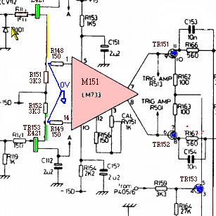

Hi Eric,
The 733 now measures -1v5 on pin 7 and +6v4 on pin 8. Wires off and pins grounded.
Does this tell you something?
Al
Hi Eric,
Al
hi Al,
Its suggesting the 733 is faulty/
You could swop the two 733's over, dont get them mixed up.:)
Then see what you get on pin 7 and 8

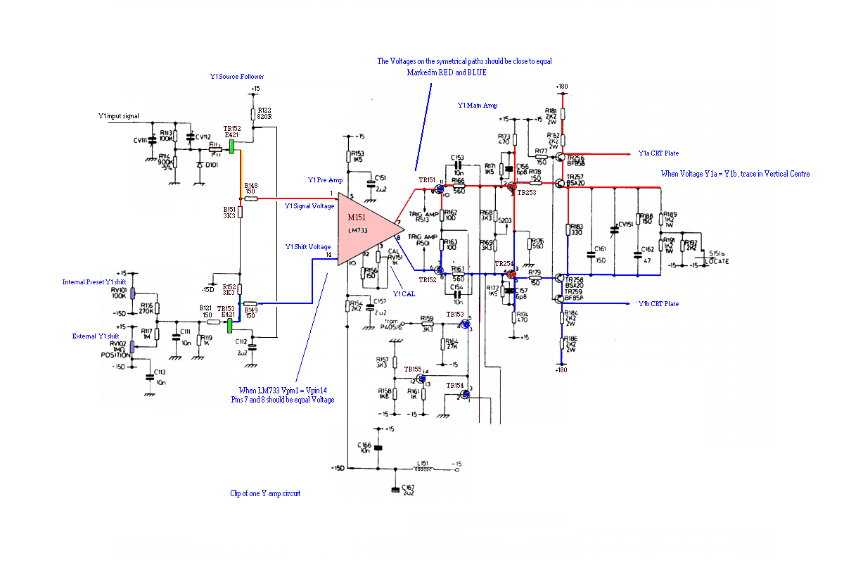

EDIT2:
All your FET's are Audio range or switching...
The best match I can see at the moment, from the web, is the PMBF J620.
You are going to have to buy the U441's...
EDIT3: added a simplified dwg of one Y amp, it should help with testing.

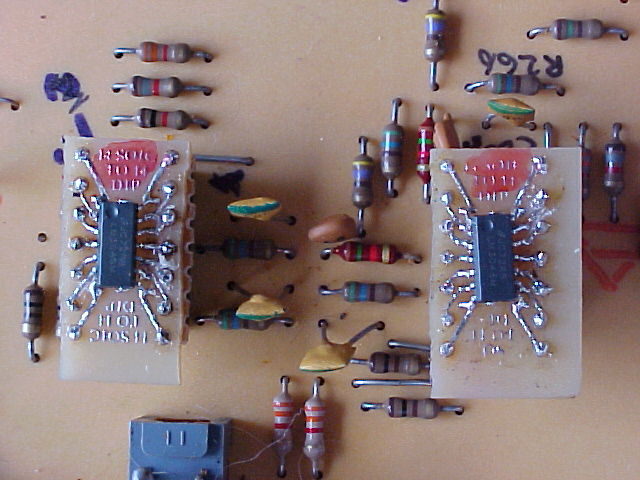

Putting them on headers would be no problem, not after making the adaptors for the CAs anyway ;) See attachment, not pretty but functional!
The NE592 is a DIP direct replacement, no header required.

Look at the last dwg I posted, it should help as a guide.
