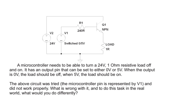

Anyone can answer the problem please?

Having the 1R in the transistor emitter, and driving the base with 5V, means that the 1R will have only 4.3V when ON.!!!

The load should ALWAYS be in the collector, not the emitter (a common rookie mistake) - and my tutorial shows both source and sink examples (sink is easiest, and only requires a single transistor).
Nigel is correct. The load should ALWAYS be in the collector circuit when used in a switching application.

To answer the OP's question, it didn't work for 1 of 2 reasons
1) you used Re= < 100 Ohms which demands a lot of current and current gain will drop under these conditions for an undersized transistor.
2) the transistor selected does not have hfe>=240 which is required for this to work.
THis might be a nominal gain for some small signal transistors but worst case can be as low as 20% of nominal. Better parts are binned in +/-25~ 50% ranges.
The OP's question image clearly states: to turn a 24V 1R load On/Off using a 0V or +5V Base drive via a 240R, no mention of Linear mode.
The question/image is obviously meant to highlight the inability of this circuit to switch 24V across the 1R by using a 5V Base source voltage.

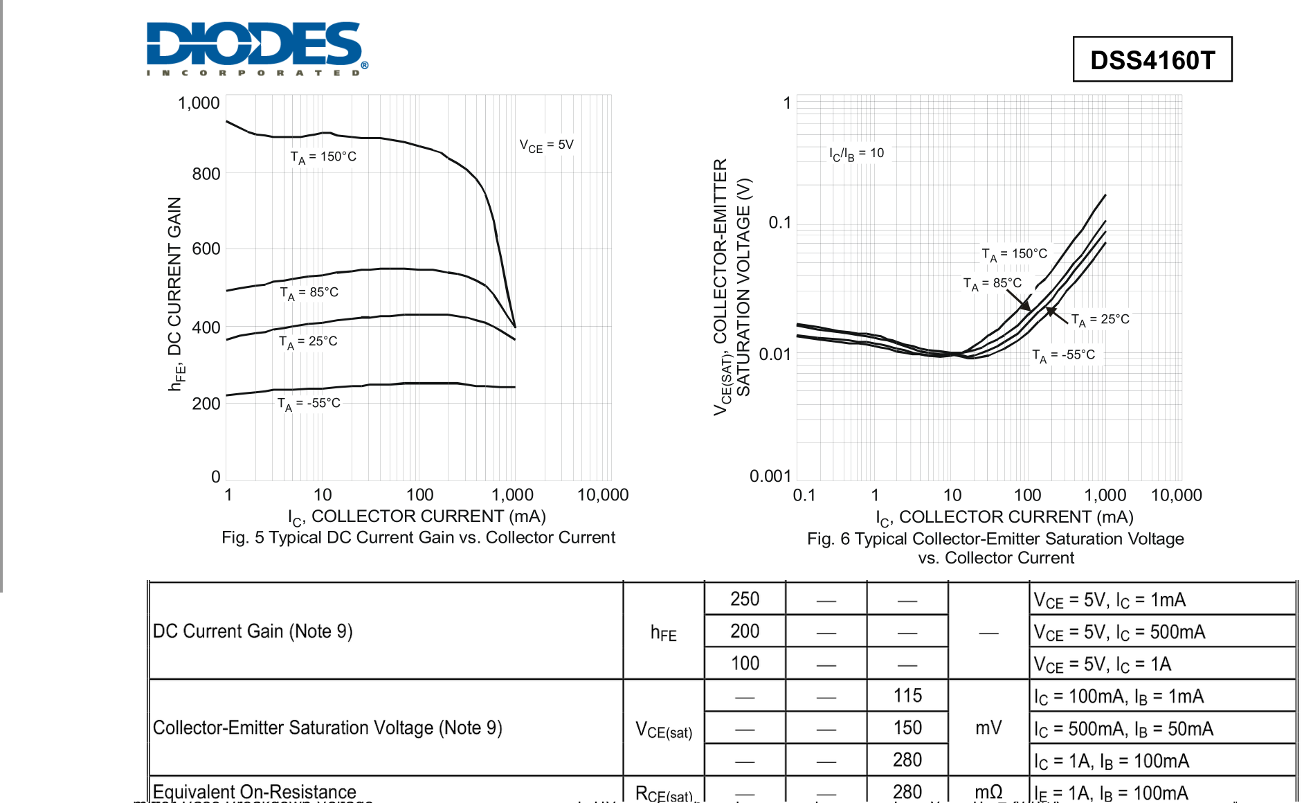

Here is a typical SOT23 automotive switch Note hFE =250 min @1mA load would work but at 0.5 to 1A would not in your example.

The original circuit didn't work because he used an emitter follower, the fact that his component values were incorrect makes no difference at all, an emitter follower isn't going to work in this instance (fairly obviously).
For this to switch 24V with 1Ω means the load is <24 Amps or 24*24= 576 Watts, if you arbitrarily choose 1% losses this is <6Watts.

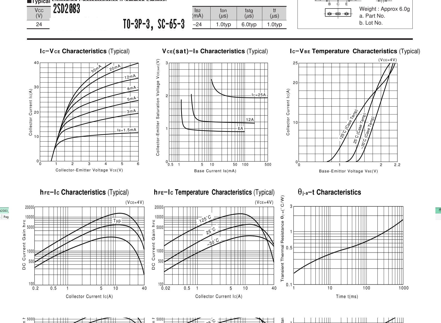

To make this work with a 240 Ω Rb from 5V will only supply (5-0.7)/240 = ~20mA source current. thus the current gain required is 24/0.02=1,200
Note for low power dissipation of say 6W the switch resistance must be 6W/ 24^2=R<=10.3mΩ
Cost tradeoffs exist for very low Rce then RdsOn in a FET and then a Relay rated at 25~30A and heatsink cost for high loss
This excellent darlington needs a big heatsink but it satisfies the current gain but Vce@24A is 2V or 48W ( like a small CPU needs a big heatsink $
the load is reduced also by drop from 24 to 22V. or 22A or 484 W but this has 10% losses.

Sid , there is no great low loss solution for 24A using BJT's without very careful selection of components in a complementary 3 stage common emitter approach.
