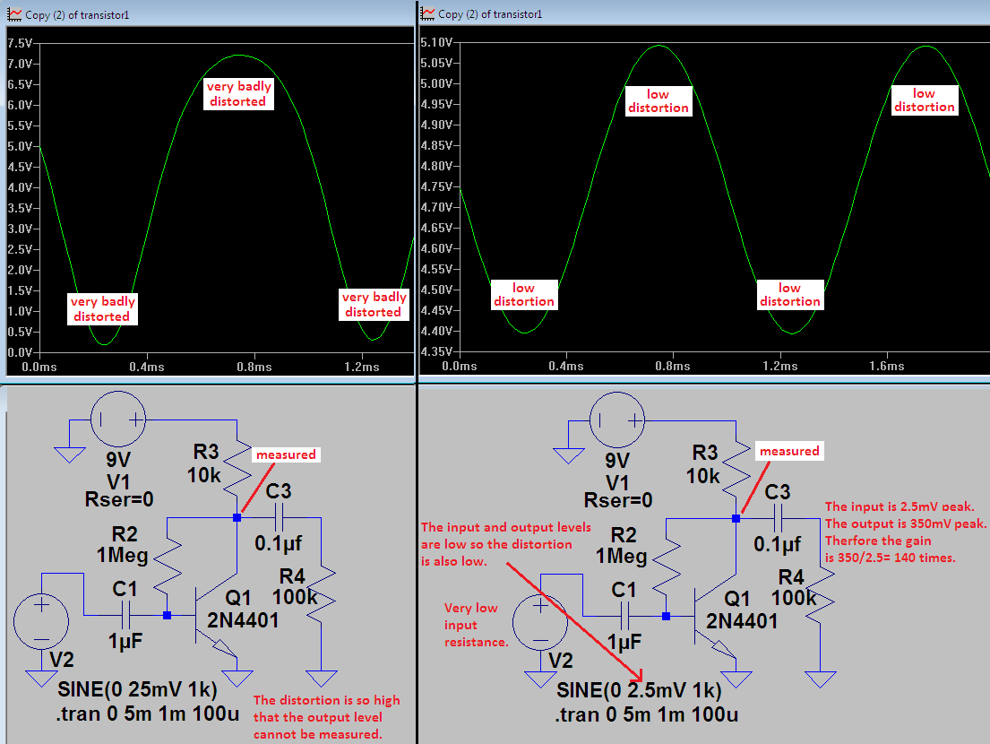

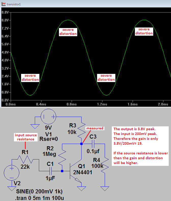

Here is a simulation of a single transistor that is biased with a single resistor from its collector to its base which provides negative feedback. the negative feedback reduces its gain and distortion if the input source has some resistance.
When the input source resistance is 22k then the gain is only 19 and the distortion at high levels (but not clipping) is very high.

Oh Yes! I know feedback R of opamp sets its gain (high gain if higher resistor) but I never thought this is same here :) . How great- current consumption is low but gain is high!
I followed your simulation and used 10Meg instead of 1Meg then-
Ib=3uA
Ic=300uA
Vb=0.5V
Vc=5V
and distortion is very high- Bad clipping. (I used load resistor 2k instead of 100k, I don't know about it but I tried to simulate like a 2k high z speaker :) )
From few years ago, I am thinking about a simple thing- you said 'input resistance' and simulated with 22k but how to determine (calculate) this resistance on real circuit? (real circuit has no input resistor) thank you.
EVERY signal source has a certain amount of resistance. The output resistance of a transistor is the resistance of its collector resistor. The output resistance of an opamp circuit is almost zero ohms.

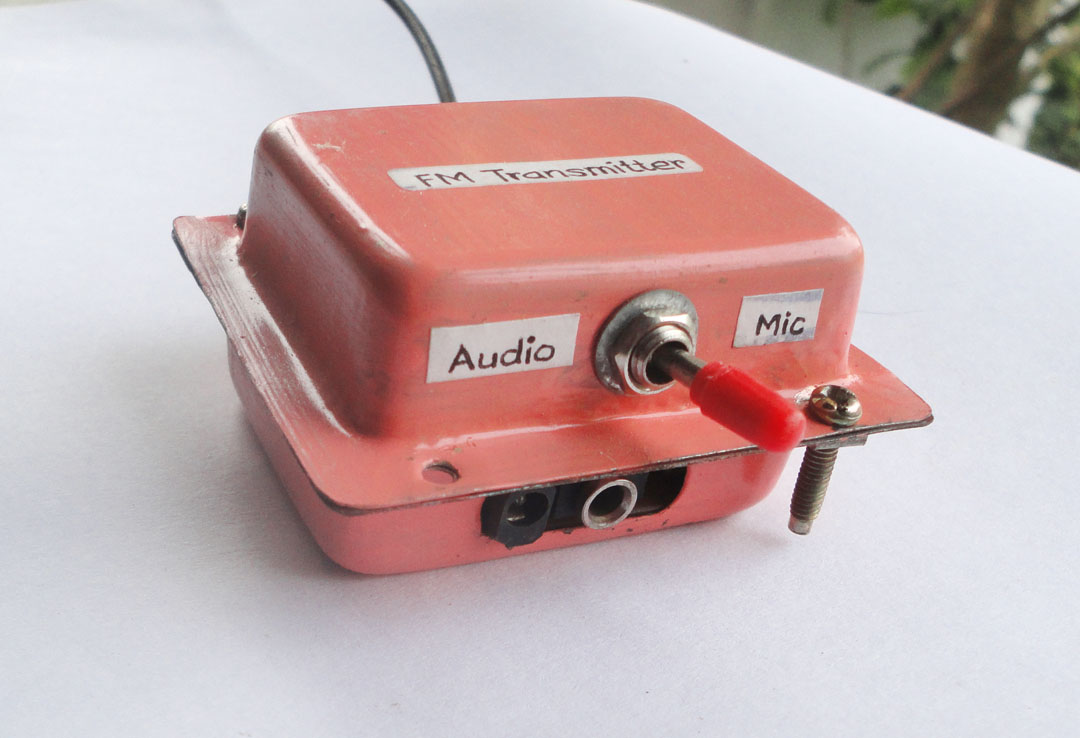

Recently I prepared a metal housing for MOD 4 and I set the Tx inside this housing. Now It's so easy to handle the transmitter :)

Did you connect the metal housing to 0V so it is a good shield?
Did the housing change the radio frequency much?
Yes! Electrically housing has been connected to 0V.
Did you mean its stability when I move near to Tx? I got no more stability improvements in this case. Even I Connected this OV ground to 'Earth Ground' to get VERY stable :) frequency but if I moved near, (2 or 4 cm near) Tx will change its frequency little. I am using cell phone as audio input using one meter audio cable (cell phone to Tx). So every time when I touch the cell phone, also frequency will change little, then Rx produce hiss (out of frequency). Happens same if I touched the battery. (battery wire is no more long than 1 feet.)

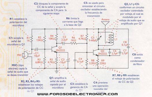

Hi AG,
I found a FM tx circuit. It has 0.1uF at its oscillator from base to Gnd (same as 470pf on Mod-4). Won't it ground (short) the audio signal instead of RF??

Another project by a student who knows NOTHING about electronics. It is good that you spotted this horrible error.
The output impedance of Q1 is 10k (R4) so R6 is not needed since it simply makes the value of R4 a little higher.
You are correct, the resistors and C4 form a lowpass filter that has a cutoff frequency of 146Hz. All frequencies higher than 146Hz will be reduced.
It has no pre-emphasis so de-emphasis in an FM radio will cut high audio frequencies even more.
The extremely low values of R7 and R8 increase the cutoff frequency a little and attenuate all frequencies to 0.137 times the level if their values are much higher.
I used 470pF as a low impedance at 100MHz (3.4 ohms) but at 15kHz it is 23k ohms and barely affects it.

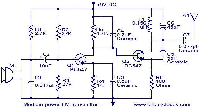

Here I found another more funny (I think) FM Tx designed by popular site 'circuitstoday'. He used C1= 0.047uF as a parallel of Mic. I thik it will cuts lots of audio. How to calculate it? (I can calculate cut-off freq. in lowpass and highpass filter, but couldn't get more idea here).
Another capacitor C4 has 0.2uF value. Double than previous circuit. Same fault like before? It has no coupling caps and C4 is connected to positive (instead of Gnd). I guessed it also shorts audio like before, isn't it?
Another capacitor C7 has been marked as 0.0022pf hahaha

Another horrible FM transmitter.
The electret mic has an impedance of about 3.3k ohms and has R1 as 2.7k in parallel so the source impedance is 1.5k ohms. The 0.047uF capacitor cuts 2270Hz and all higher frequencies.
The 0.2uF capacitor C4 is parallel with 4.7k so it cuts 170Hz and all higher frequencies.
The battery is missing a parallel capacitor so when the battery runs down a little and its internal resistance rises then the circuit will probably suddenly stop working.
The value of the 0.022pF output capacitor is made by having the circuit in one city and the antenna in another city, fairly far apart. Hee, hee.
A 22pF output capacitor will work fine.
