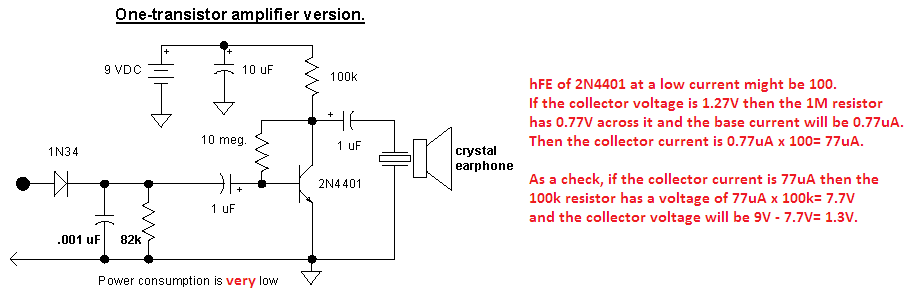

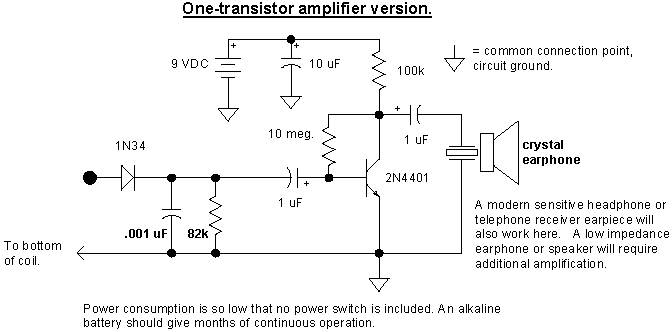

I found a post here where you were calculating Vb, Ib and bias resistor with Vc, Ic and hFE. That was so clear to me. But I saw a circuit where used a base resistor is extremely high 10 Meg. It is a crystal radio amplifier.
(also i found a VLF receiver with a single jEET which has 44 Meg resistor for base bias and this base was antenna too. And collector of the device was connected to Mic in. I can attach it if you want.)
You were calculating with 1 Meg base resistor with almost 110 to 800 hFE. Here this transistor has almost same hFE around 200-300 BUT what is the purpose to use such large value resistor here (like 10 Meg here or 44 Meg on jFET)? Should we have to use larger R if base input has smaller signal?
Are there any interesting Vb, Ib, hFE, Ic, Vc etc. calculation related with the circuit? Thank you.

Nepaliman, the high resistor values used in the schematic you posted are used to keep the power consumption VERY low.
I calculated its voltages and currents when the hFE of the transistor is only 100 but you should re-calculate with the hFE at the minimum of 20 at a low current or with the hFE of typically 200 at a low current shown on the graph. The hFE might actually be 300 which will cause the transistor to be almost saturated and therefore work poorly as an amplifier.
