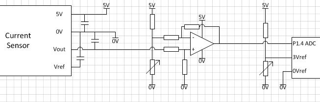

Thanks for the quick reply, please see attached circuit
Tom
With the divider pot in that position you will also be changing the gain of the OPA.
The 5V feeding the divider circuit should be well regulated.
You have not shown any component values, what is the signal range from the current sensor.? and how much gain is the OPA set for.?

the resistors in the leftmost divider: res=10k pot=10k
input resistors to OPA = 2k
res to ground and feedback resistor are both 200k
hope that helps

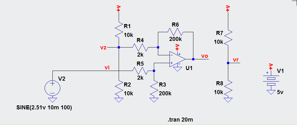

I have attached a pdf and an image that should give you a better idea.
  • SigCond1.pdf

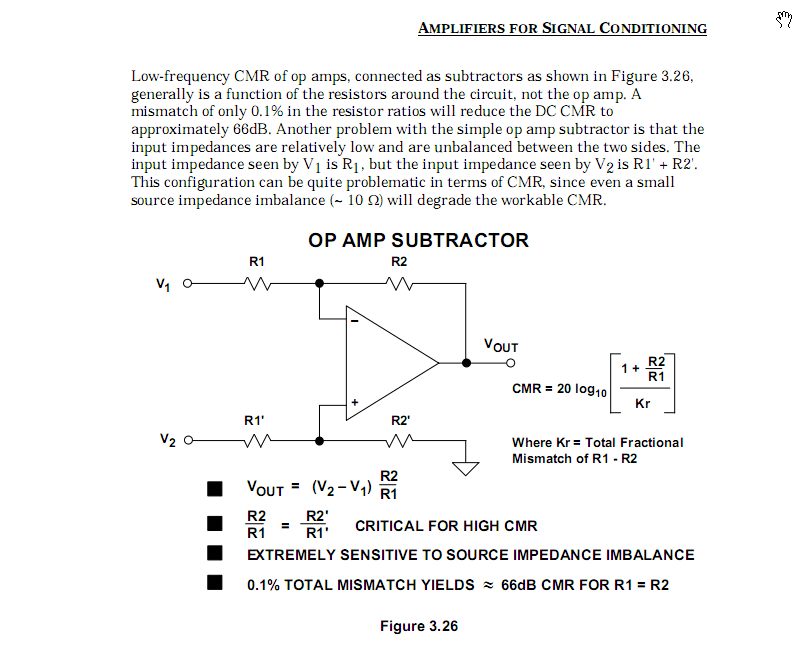

If this is a correct representation of your circuit, the source impedances are well out of balance so the CMRR will be very poor, also are you using high precision resistors around the OPA.?
what effect will the poor CMRR have? I'm not using precision resistors, but have measured there values to make sure they are pretty similar and yes that is the correct config of my circuit. Would you say the divider branch is affecting the circuit? Shall i put a buffer between it and the OPA?
Unless you use high precision resistors common node noise will be a problem.
Did you see my image for the OP AMP subtracter.? this will give you an indication of the cause of the problems you are having

An alternative circuit would be very helpful. Thanks for your help and I have seen the subtracter image, which makes sense to me. I didn't realise such small deviations in resistance would have such a large effect. So the varying output I am seeing is noise? Could you also define "precision resistor" - 1% tolerance?
Hi
A precision resistor is where the marked resistance is very close to the actual resistor eg: 10K +/-0.01% also they usually have a lower noise value.

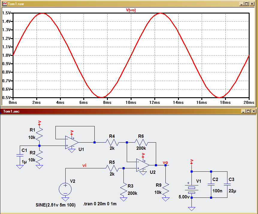

Look at this option. it uses the MC1741 amps that you have. See the EDIT.!
The 5V must be very stable and noise free.
EDIT:
Rechecking the datasheet for that OPA suggests that its designed for a dual supply also its output voltage range is limited.
Look at the MCP6002 opa
The 741 opamp was designed 42 years ago to use only a 30V supply. Most do not work with a 10V supply and yours is only 5V.
Use a more modern opamp designed to work properly with a supply as low as 5V.
