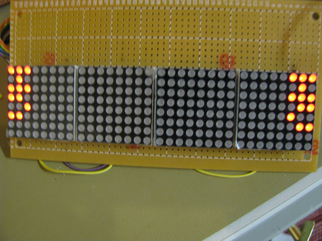

(Solved)Again problem with matrix, this time 8x32

backbuffer[0] = second; // which is those corner columns displaying seconds, hr, minute, values in a un-decoded binary format of 0-255 (the size of a byte)
that part was done to verify that charput was working ok

shiftout was replaced mostly with setpos & setdata, and handled with interrupt_handler, shiftout could have been used, but again , thats my substitute for not knowing the library well enough.. I just use my own "bit banging"
I now realized that I read fontmap entirely wrong, thanks for educating!

At first, it showed 8585, then re-set time, wait while to check whether time will stay on memory, in the end it worked
now then, I tried again previous codes:
post #263, all empty
#264 FLICKERY seconds counter in place of 85 (wohoo)!
#273 same as 264
#274 whined about missing backbuffers, same error as earlier from that
#291, nothing on seconds place, empty except corners (some random flicker), but figures are mirror, see photo
and last, #293, flickery clock HH:MM format
lol, thats rite, i did the mirror cause i forgot which side backbuffer[0] was.
Post 264 is where we cut out the interrupt, strange that it did that , and that it started working suddenly, try to reupload post 264, if it shows 85 then how long till it starts working? also let it run for about a minute or 2, also it should be scrolling,dont worry about flicker...yet!
also, just as fun, check out the first column in backbuffer from your last photo, you will notice that that is your seconds value in binary format, going from bottom to top, ob00101101 = 45 , so that photo was taken at 21:47:45 <--or 9:47pm!
Also,I noticed that switching digitalWrite() to port manipulation, scroll speed can be much better controlled by keeping refresh rate for interrupt constan (~2khz) but delay after commands keep screen readable!:

thats rite, the delay is used at the end of the for loop to hold off before writing new values to the buffers
also go with the port manipulation if it works faster, but really you want to control the flicker/refresh rate with OCR1A
soo cool!, glad is working , got worried for a sec there!
^did we make binary clock by accident? :p
ut road is not end yet...
ohya, that ORCA1 may not work till we re-enable the interrupt, dont worry too much about that we can do final tweaks for that later.
I am worried though that you cant see scrolling, what about the binary values in the corner, they should be changing with time?
if not this could indicate we are still having problems reading from rtc
