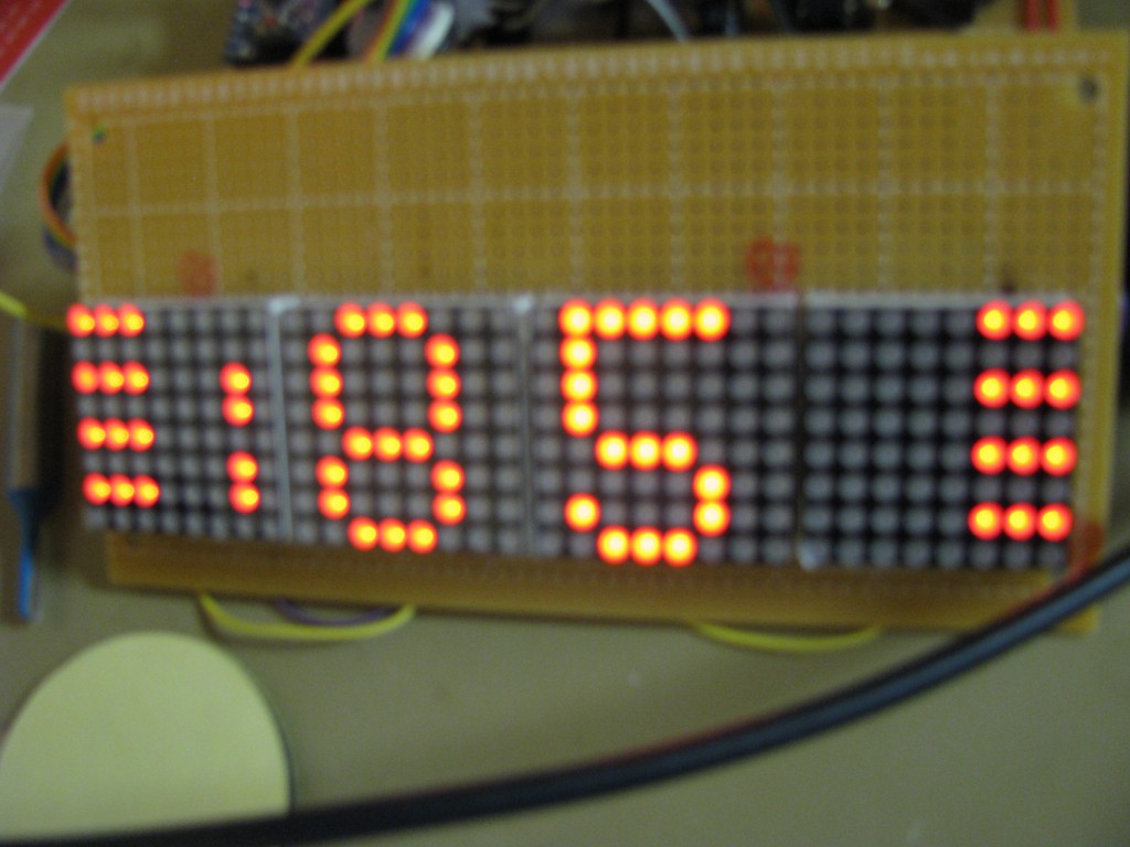

(Solved)Again problem with matrix, this time 8x32
No errors, but nothing on serial or screen either....I did upload it :D

Hmm, nothing, all empty?
C:

hmm, this is puzzling to me, i cant see how there is anything different that would cause this, we know the main loop works to display seconds, but its not even displaying colons,here is a shot , all i can think of is conflict with interrupt, so i will bypass, but if this doesnt work we may need to sit back for extra help...
...dont worry about serial for now

doggy, slight progress: (had to decrease delay() in loop() end to make it more readable)
hmm, it seems we have 2 problems here, rtc doesnt like us using our interrupt, also I am not sure why its returning 85 for all the values, do you have it running on backup battery/ is it able to hold time yet? still 85 is a strange number, i suspect communication errror, still not too sure what to do about this...
yes, RTC is all the time with battery
thanks for input, thing is I don't have any 85's only arduinos and teensy's :/
Oops :D...
that is my debug view, instead of having breakpoints:
second = now.second();
minute = now.minute();
hour = now.hour();
charput(58,2,0); // indicate that we make it to this point
backbuffer[0] = second; // display rtc output
backbuffer[1] = minute;
backbuffer[2] = hour;
backbuffer[31] = second; //display rtc output symmetrically
backbuffer[30] = minute;
backbuffer[29] = hour;
85 is the seconds value, but as you can see in the corner columns on display, 85 is getting returned for the minute and hour vals too, 85 = 0b01010101
we need to get proper vals from rtc, before we can display them , then maybe we will fix that funny looking 5 & 8, and the spot they appear, last few tests prove that we are able to display and scroll what ever we pass in
personally iv never used RTC library , and dont use any library much, would rather learn the protocol and write my own instead of having to relearn the bugs to libraries every time i switch compilers, which is what i mite do if someone doesnt jump in!
As my previous post, this happens if you have not started the 1307 osc,, write 0 into reg 0.
seconds and CH
oh, sry, didn't get what you meant there, any chance you could write the line of how to do that? also should there be more than one occurrence?

OH! And i now remembered, my main idea back in the day was to use matrix as display for text, and that space you see above matrix is for 7-segments, I got them while ago, but will it make our (or should I say yours) job easier if we use 7-segments for time? It's not that big deal to expand controller board! :)
doesn't matter really, rite now its setup to display what we want, which we control in main loop, really its just the RTC plug that we need to figure out, which i think grandad is about to educate us both with...
once the time is able to plug in, a little alignment and we will be done, just cause i have never used a rtc clock, and any i2c i have ever done I have used my own library,
displaying text will work with this code too, after we complete the fontmap for letters.
hscroll would be easy to implement since its just a mod of vscroll, also we can set it up so you can choose which way it scrolls if you like.
