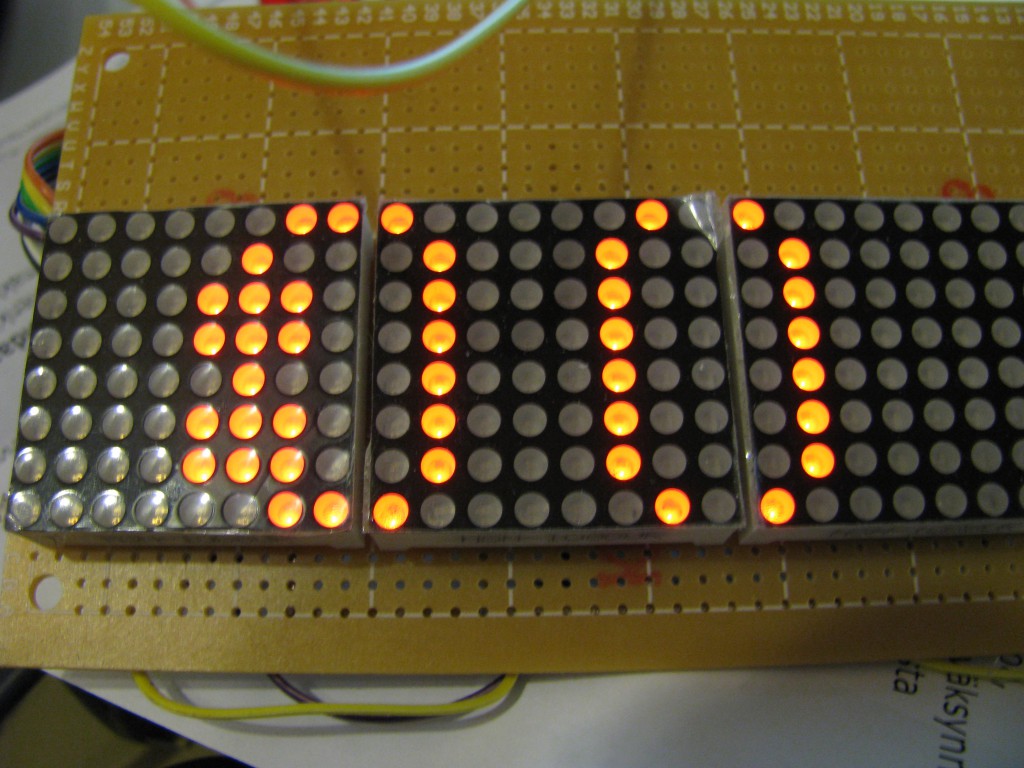

Hmm, when entering serial mode, all leds are lit and says only "Th" trying to say thank you?
ya, or Thursday, but i deleted both of those, could be cause of our clock settings, serial port may have bad timing, lets try to cut programming time/serial functions completely

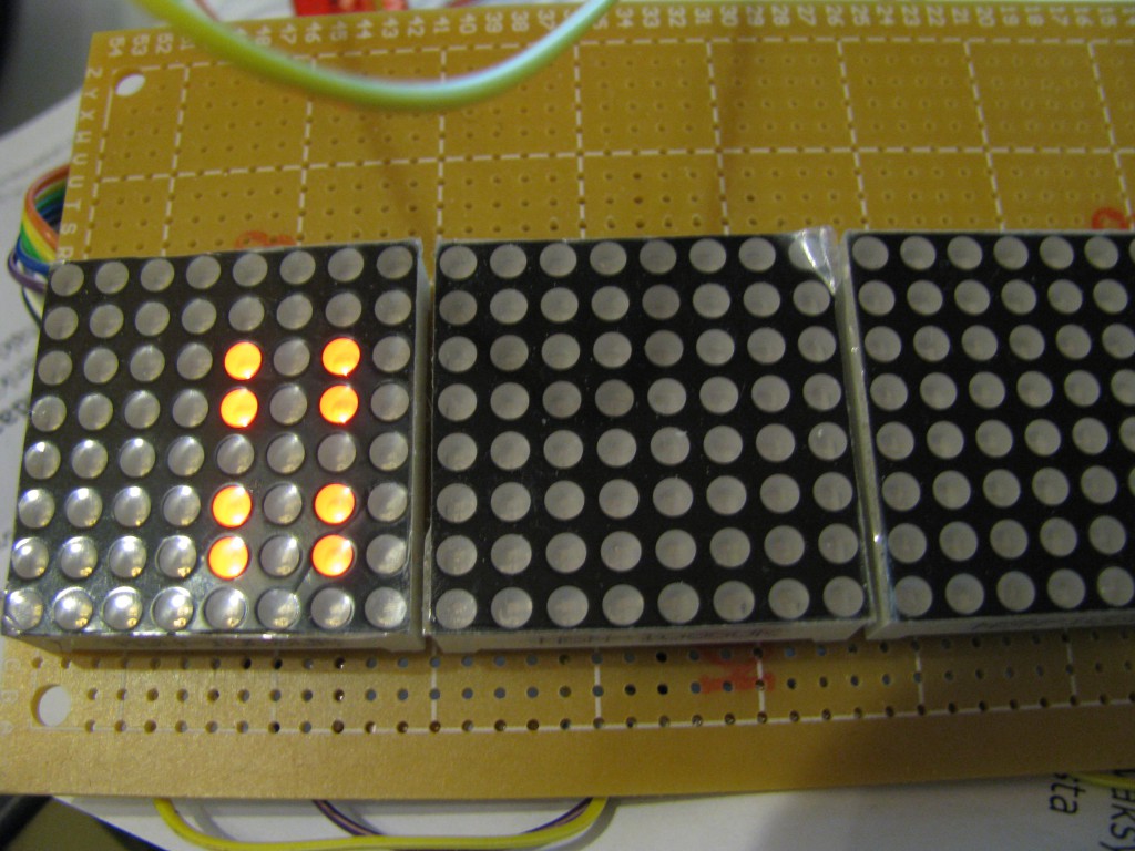

hehe, now screen and serial are both blank
...maybe not!

Serial is empty, but every now and then couple zeroes pop to quite middle of matrix
I cut out serial port for now, lets double check to see if scroll still works

Serial is empty, both of those earlier dots and zeros are now visible , slightly shifted to left.
remember where there were two zeroes? those now scroll, counting up, 00, 01, 02, 03 etc....but very slowly, would take too long video to upload :/ and, serial is empty
doggy, with this I got hours & minutes on screen, only bit flickery, is there any help on this?
C:

C:
Arduino: 1.6.7 (Windows 7), TD: 1.27, Board: "Arduino Pro or Pro Mini, ATmega328 (5V, 16 MHz)"
C:\Users\Atte\AppData\Local\Temp\arduino_6d4799411362b184c1851ba8af345ff2\sketch_jan21a.ino: In function 'void loop()':
sketch_jan21a:168: error: 'now' was not declared in this scope
 minute = now.minute();
exit status 1
  This report would have more information with
  "Show verbose output during compilation"
  enabled in File > Preferences.

DateTime now = RTC.now();
second = now.second();
hour = now.hour();
clr();
charput(58,-3,0);
charput(58,14,0);
if (second != secondBK){secondLA = secondBK; secondBK=second;scrollctrSE=8;}
if (scrollctrSE > 0){scrollctrSE = Vscroll(second, secondLA, 15,0,scrollctrSE);} else {charput((second/10),15,0);charput((second%10),23,0);}
//if (minute != minuteBK ){minuteLA = minuteBK; minuteBK =minute;scrollctrMN=8;}
//if (scrollctrMN > 0){scrollctrMN = Vscroll(minute, minuteLA, 19,0,scrollctrMN);} else {charput((minute/10),19,0);charput((minute%10),27,0);}
//if (hour != hourBK ){hourLA = hourBK; hourBK =hour;scrollctrHR=8;}
//if (scrollctrHR > 0){scrollctrHR = Vscroll(hour, hourLA, x,0,scrollctrHR);} else {charput((hour/10),x,0);charput((hour%10),x,0);}
Blit();
delay(100);
//if (virtual_timer > 0){virtual_timer--;}else{virtual_timer=10; second++;}
