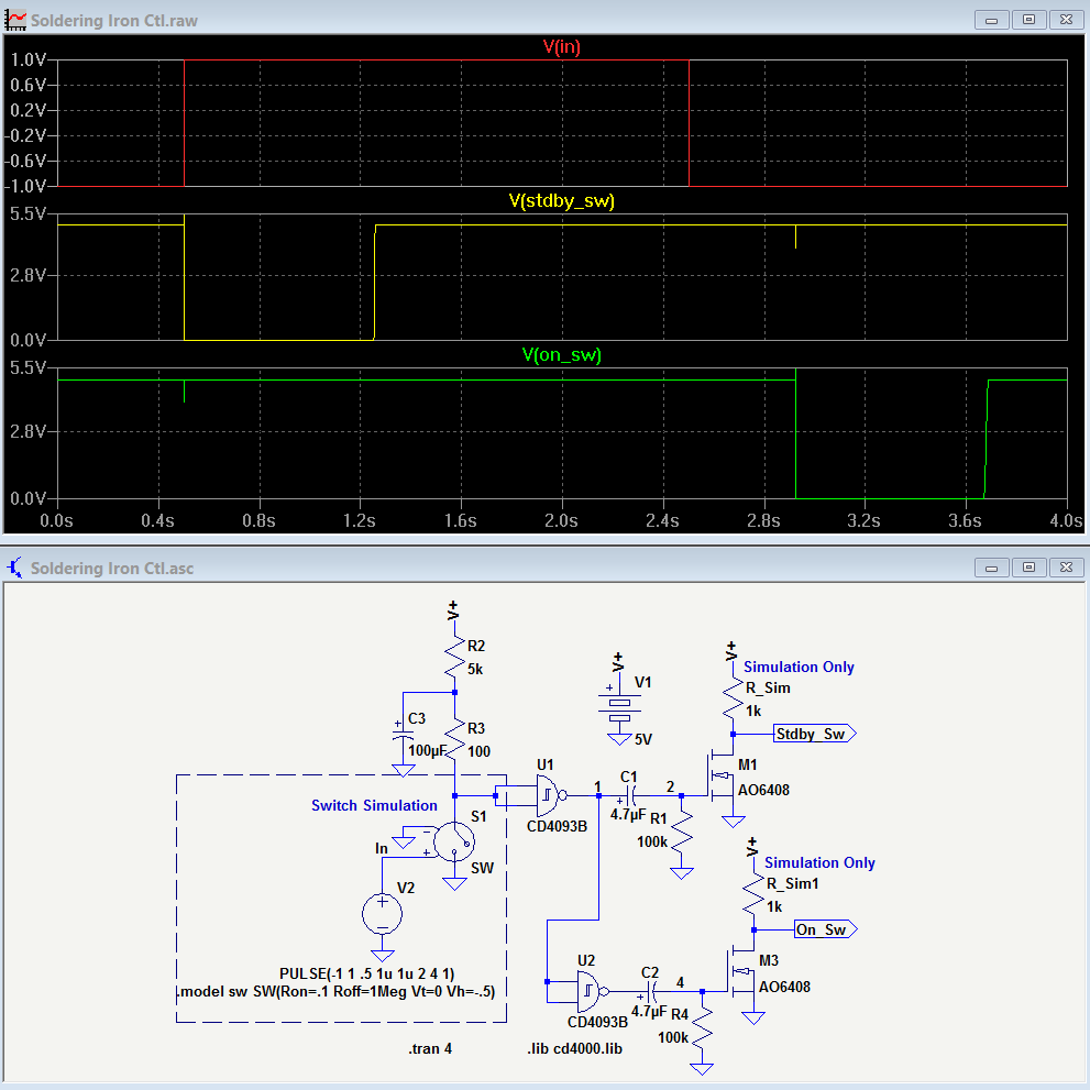

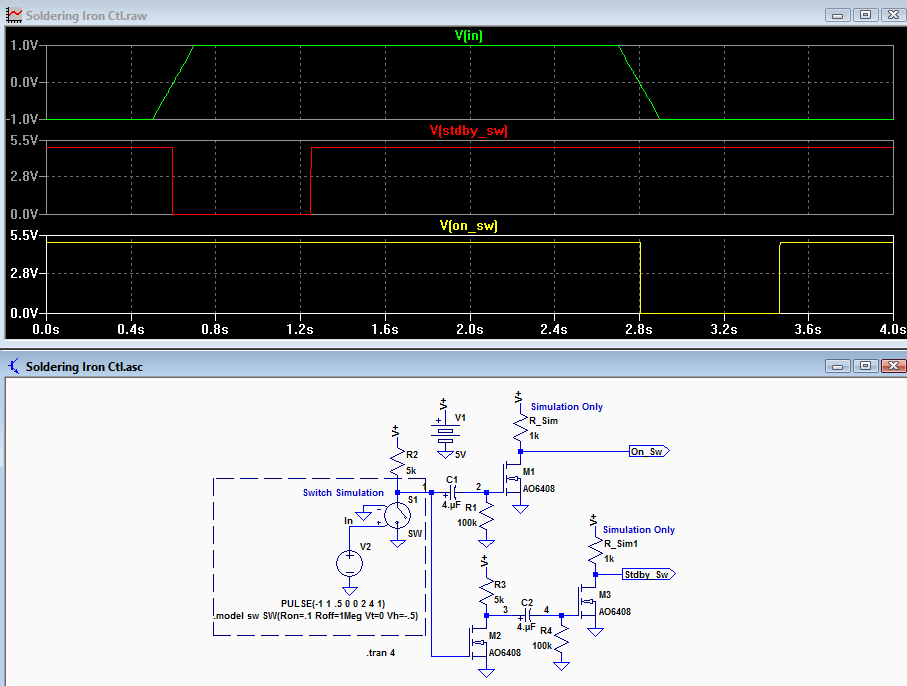

Below is the LTspice simulation a simple circuit that should do what you need.
It momentarily closes the Standby switch when the switch closes, and momentarily closes the On switch when the switch opens.
The circuit assumes that one side of each switch is connected to ground.
If not, then a different circuit will be needed.
The R_Sim resistors are for simulation purposes and should not needed in the actual circuit.
The transistors can be just about any N-MOSFET logic-level types that have their Rds(on) rated at a Vgs [not the Vgs(th)] of 5V or less as shown in their data sheet.

aardyvarky: I don't think that is big issue if it set to "set tempature" mode, because I don't need to adjust tempature. If I really need, I can unplug relay then.
crutschow: I need that delay because otherwise relay will goes on, off, on, off, on many times when I put iron to holder, because it is not that good made contact with iron and holder.
Thanks for schematic! Looks nice! I'm also finding software for scematics and looks like that LTspice is free? Is it useful to study?

I need that delay because otherwise relay will goes on, off, on, off, on many times when I put iron to holder, because it is not that good made contact with iron and holder....
Okay.
I modified the circuit to add a debounce delay to the input by adding some Schmidt trigger NAND gates (used as inverters).
(The power and ground are not shown for the gates and must be connected. Also any unused inputs should be grounded).
Yes, LTspice is one of the best free Spice simulators available and is used by several on these forums.
It would be well worth your while to download and get familiar with it if you are interested in circuit design.
