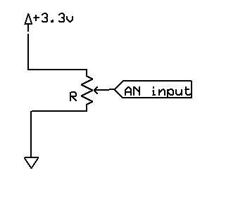

Okay, but I am still not sure what value to compare to light the led. For the voltage, can I use a lm317 with and input voltage of 5V and (2) 220 ohm resistors to get a contact output of 2.5v for testing?
Yes u can...just measure the voltage with a DMM 1st...it must be < the PIC vdd or bye bye ADC. Prhaps u should put a 1K in series withthe ADC input b4 u give it your ref voltage.
2.5V will work out to 2.5/3.3 * 256 = 193 or 194 ADC value.
Okay got your post after I started testing. I can test more tomorrow night and want to test the other two wired pics.
For 2.58V I should get a ADC value of 2.58/3.3 * 256 = 200. I am getting 385
For 3.3V I should get a ADC value of 3.3/3.3 * 256 = 256. I am getting 1010.
should be more like 771
Your reading more like a volt
I would put a pot with one side to gnd and top side to vdd and the wiper to your adc input
You can set it at any volts from 0 to 3.3 volts
Like this
I used a LM317 with two 220ohm 1/4W resistors. Vdd out on my DMM reads 2.58V. The pot is a good idea and I believe I have an extra, but I would still have to use my DMM to check the output correct? What would the pot provide that the LM317 is not?
Do I need a common ground between the voltage source and the ADC?
You can test a larger range of volts. And I think you'll see whats going on.
See your reading a word and trying to change it into a byte.
That's where your getting your error

Let me look at your ADC code and I'll post some thing to show you. I'm not sure if you have this set right
bit 9-8 FORM1:FORM0: Data Output Format bits
11 = Signed fractional (sddd dddd dd00 0000)
10 = Fractional (dddd dddd dd00 0000)
01 = Signed integer (ssss sssd dddd dddd)
00 = Integer (0000 00dd dddd dddd)
You Data Output Format bits are set for Signed fractional
