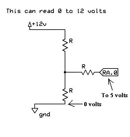

You need one of these I didn't post resistor values because it was for 12 volts using a 5 volt chip
But if you can't figure them I'll post them for 3.3 chip in a sec.
Ok to read 5 volts
5volts <--------------------------
                                1K
                                 |-------1k-------- 3.3 volts
                                2K
0 volts <-----------------------------------  0

If my VRef is 3.3 would I have to go lower than 3.3 volts?
