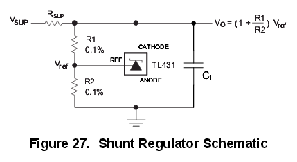

Typically:
-Vref is connected to ground
+Vref can be connected to +supply but a +5V supply is not as good as a real reference
+Vref can be connected to a reference like 4.024V or 2.5V or......
SO
We are saying that +Vref can go to +5V and -Vref can go to a reference just as well.
Vsup is you 5V.
Rsup could be 1k to 2k. Needs to have 1 to 10mA of current.
R1 and R2 should be in the 10k range.
Vo is set by the formula. If R1=10k and R2=10k then Vo=2.5V Increasing R1 will increase the voltage.
Cl could be 0.1uF
TL431 is a little "transistor" looking thing. Three legs.
