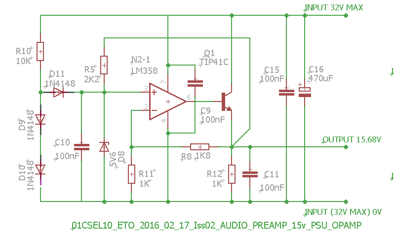

Excellent AG, you have spotted the obvious shortcoming- it is only an outline design and I couldn't be bothered to sort the startingI do not see how the zener diode-opamp-transistor power supply in post #81 starts. When power is applied then the (+) input and output are at 0V so they might stay like that. I know that the LM358 uses PNP input transistors that try to pull the inputs positive a little but both inputs will go positive a little. But the (+) input has a higher resistor value but again if the input offset voltage is the wrong polarity then it will not work.

Your circuit look pretty like basic of what inside a LM431 and the circuit in my friendy's guitar preamp use 8V2 zenner and LM741 opamp.

It would be much better if you could power the preamp from a separate winding on the main PSU transformer or, better still, from a separate small transformer.

Although it will do no harm, it will not be necessary to shield any wires except those carrying high voltage AC.
