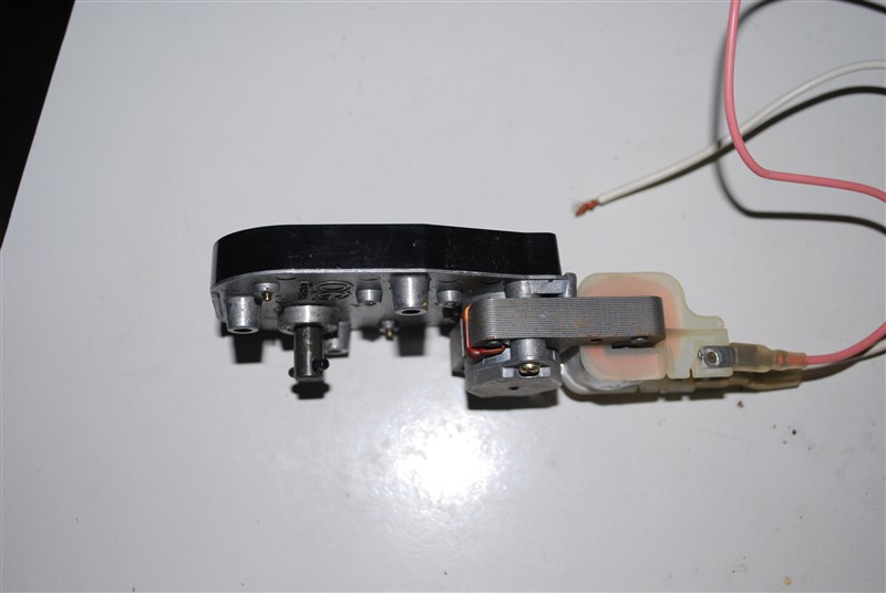

Hi Everyone,
About 10 yrs ago I was in need for a small tumbler for Stainless Steel components & used a very low powered geared motor from a Microwave Oven, it must be only about 4W & just plugs into the mains supply. My wife used it continuously for years tumbling stones.
I have made many things from these including being used as the drive motor for a profile cutter etc & you can find hundreds of them at scrap yards for next to nothing.
This is the type I use, they are Japanese & they last forever, see picture below.
