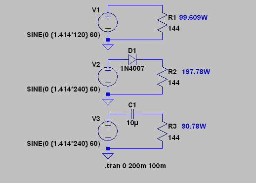

How about:

Mike, good use of spice!
Using a capacitor as shown in Mike's last simulation has the possible problem of generating a very large peak current if the switch is closed when the waveform happens to be at it's peak voltage. That would put double the peak starting current (and four times the power) through the bulb when cold as compared to starting on its rated voltage. It may not blow the filament but it would certainly be an added stress.
Yes there are some drawbacks to using a cap.
First, it takes a relatively large, quality cap to get the required power at 240vac.
Second, the line current is around 1.1 amps (apparent power is over 240 watts) while the power in the 'load' is only about 91 watts. A 91 watt resistive load would be around 633 ohms at 240vac (rms) and draw a current of around 0.38 amps. So the power factor is pretty low.
On the other hand the triac solution generates spikes on the line which are not super simple to filter out.
We could look at an inductor solution too (although it would take a 0.7 Henry inductor to get 91 watts ha ha), and also an LC solution to maybe keep the power factor high.
There is also the "chopped" solution which presents a PWM current to the load. The input is chopped up with PWM to reduce the total power that gets to the load. The higher frequency PWM makes it easier to filter.
I like the two bulb idea best because it doesnt involve any additional circuitry, as long as the application can accept two bulbs in a place where there is normally just one. To keep the power down, we could use bulbs at half the power of the original and that would keep the power and the lighting about equal.
