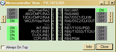

This is your PIC as powered up, no buttons pressed,,, RA1 is high.

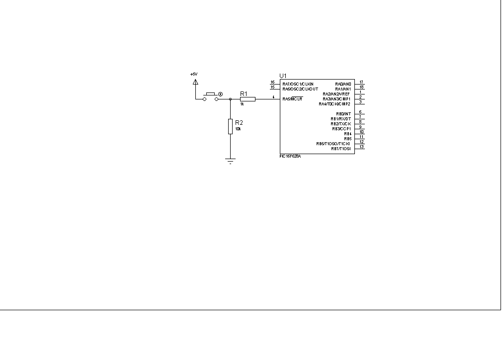

I am using the QL200 Dev board, and the switch is connected like this:

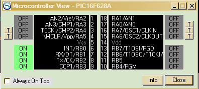

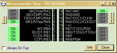

It runs OK in simulation see these two images.
The first one is when RA5 is low at power on and the second when RA5 is high at power on.
Disconnect the switch from RA5 and ground the pin, power up, check if RA1 is on.???
