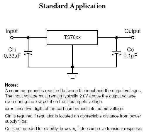

7805 and 7905 voltage regulators
7805 PDF
Cicuit on 7805...
