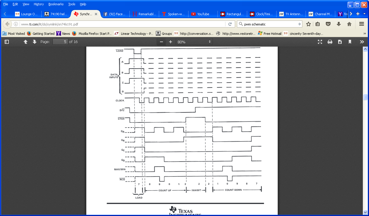

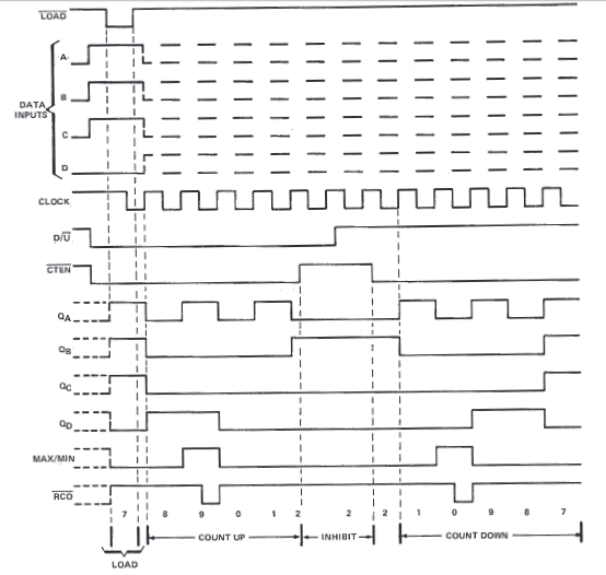

I have edited the thread title for you.
When the part is counting:
Load is high, CTEN is low.
