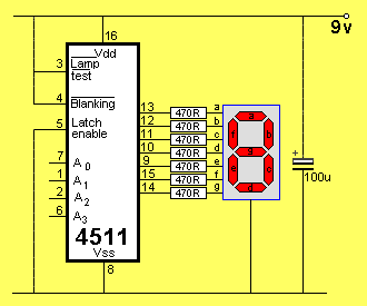

Lets start again.... Forget any driver.... The schematics from the "TheLearningPit"... Are they what you need?

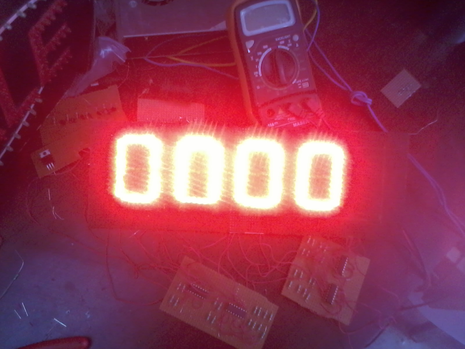

Hello,
yes it is true! current per segment is ~6mA i have measured! in 5 string LEDs may some ore error in Digital multi meter may be.

Hello,
The Vcc is 12.42 right now is adapter SMPS after that there will be transformer!
total current is 222mA for 0 in 4 digits!
the voltage across string is 9.96V, Vf of led is 1.92V, current per segment is 8.89mA and voltage across resistance is 1.8V.

Here is the circuit only Vcc at 12V, and input with pull down of 10k and input of 9.4K same!

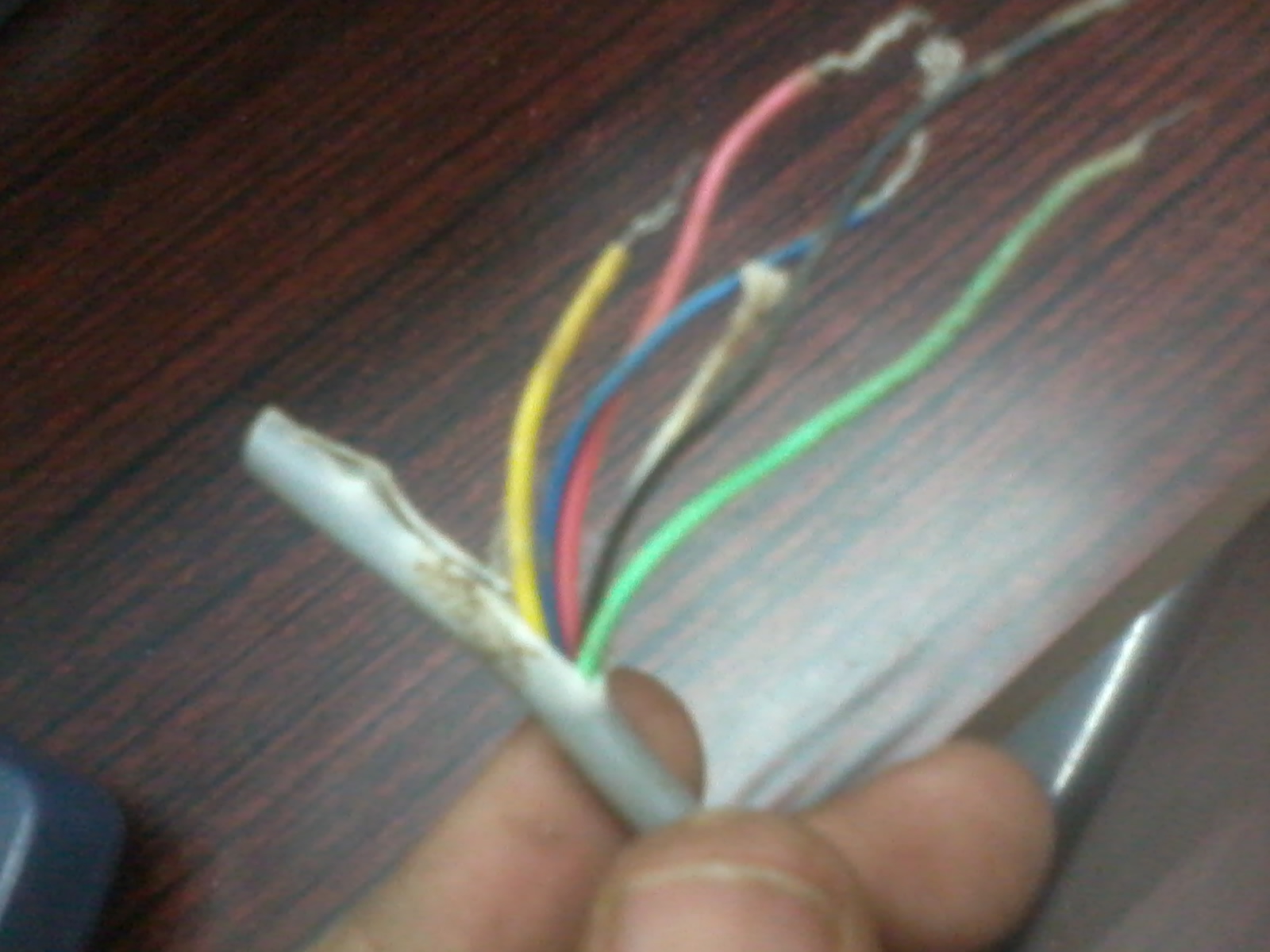

One thing more the input wire i have is cable of 5 wires. in circular color coded (I don't know the Name)
what will be the maximum length of input wire to work on it?

You multimeter most likely has a series resistor like 10 or 100 ohms when measuring current. That's why we asked for th voltage across your resistor rto get current.
