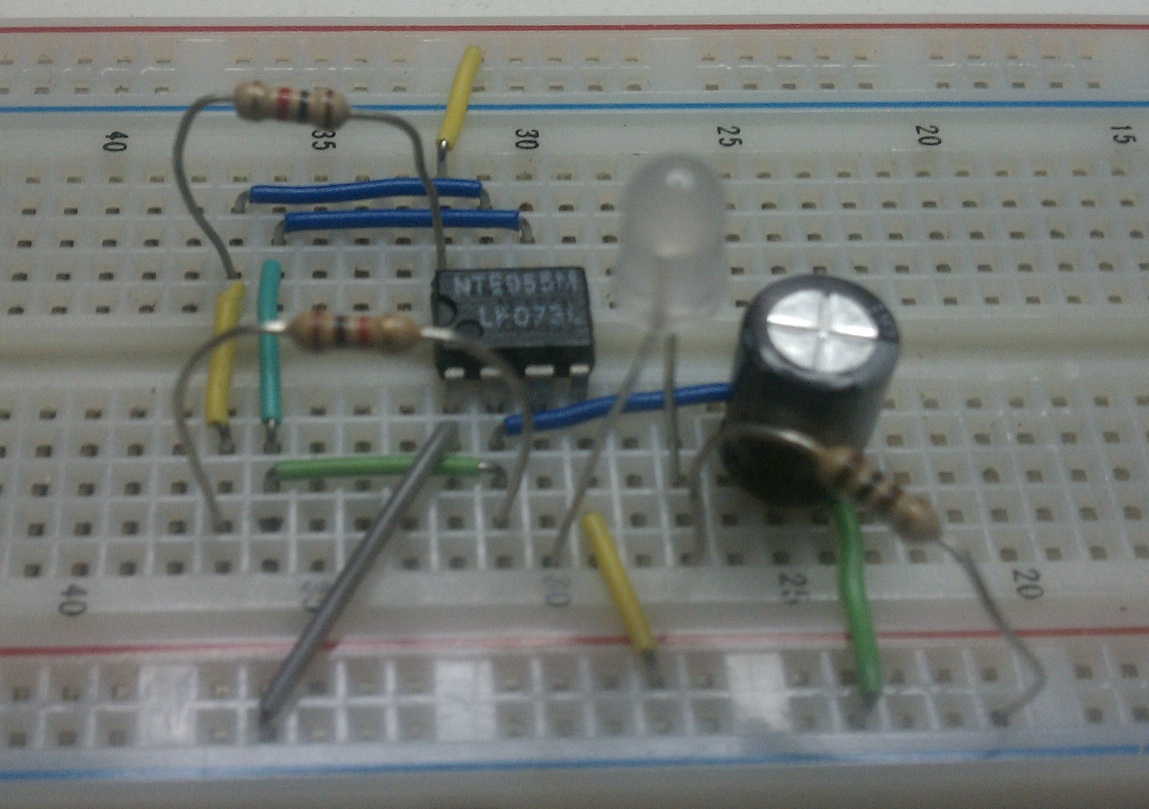

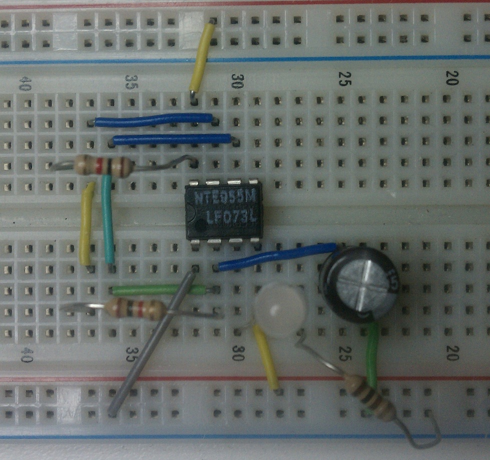

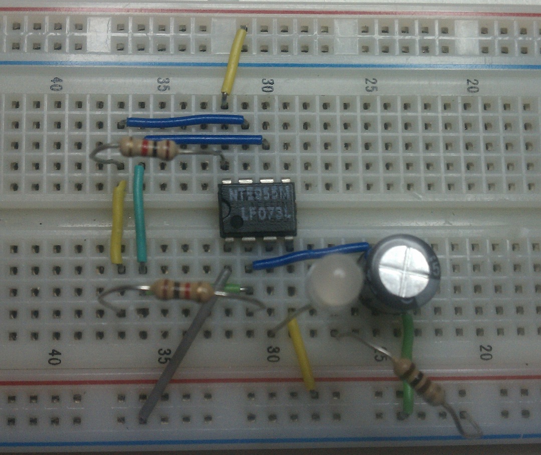

This is my first electronics project. I am trying to do the 555 / 556 Timer IC circuit for a halloween project I want to do, but my LED wont blink.
Here is the tutorial I am trying to follow:
https://www.youtube.com/watch?v=bJa0oiV6B24&feature=player_embedded#at=103
(yes I realize this is a 555 tutorial and I am using a 556 chip...I have got a schematic of both to match the pins)
Here is what my breadboard looks like:
The cap is a 6.3v 100uF and the resistors are 12Ohm if I am reading the bands correctly.
Oddly enough if I pull the resistorfrom pin 14 and 1 the LED comes on, but no blink???
Any help is appreciated...:confused:
I can't be sure because I'm reading this post on my phone but the color bands look like brown-red-black. If that's the case then those are12Ω not 120Ω resistors.
EDIT: Also, even if the resistors are correct, 2 120Ω resistors and a 100µF cap would produce a frequency of about 60 Hz which is a little faster than humans can see. Change the resistors to 5 kΩ and that should make the LED blink at about 1.5 Hz.
First of all, yes--the resistor you have is 12 ohm, which is way to small. Your LED is blinking, but it is flashing too fast for you to see. Try using a 1K resistor instead (brown, black, red). This should solve your problem.
Good luck!

I looked over your pictures and it appears to me that everything is wired correctly. With 2 1kΩ resistors and a 100 µF cap you should definitely be able to see the LED blinking. I built the circuit to show you what it should look like. Here's a video:
Astable 555
One thing you can try to troubleshoot would be to add a .1 µF cap between the control voltage pin and ground. You didn't mention if this is a CMOS or TTL chip. What exactly does the chip have written on it? CMOS are very sensitive to static dischsarge so if it is, maybe you accidently damaged it. Also, the 556 is 2 555s in one package. You could try to build the circuit using what is now the spare 555. Maybe the one you're using now was damaged. You could also try a whole new chip entirely if you have another 556 or even a 555. BTW, what voltage source and voltage are you using?

The cap you are using is only rated at 6.3V and your supply voltage is 9V. The cap won't see the whole 9V but it will see a voltage very close to its rating. Just for good measure, you may want to swap it out with a higher voltage cap.
EDIT:
Just noticed something that could be causing your problem. The resistor you have in series with your LED is only 12Ω. That is WAY too low. The blue LED probably has a forward voltage drop of around 3.5V. That means that when you apply 9V to it:
V = IR → I = V/R → I = (Vs - Vf)/R → I = (9V - 3.5V)/12Ω ≈ 460 mA.
I'm not even sure if a 9V can supply that much current when shorted so the LED may have never seen 460 mA but it almost certainly saw more that the 25 mA or so it should have flowing through it. If you allow too much current to flow through it, it can burn out. But, that's not your only problem. Depending on exactly what type of 556 it is, you could have exceeded it's maximum current too. That very well could have damaged it.
Long story short, there are a host of other potential problems introduced by the 12Ω resistor in series with the LED. Change it to something like 270Ω - 1000Ω and try again. If it still doesn't work, I'd try the spare 555 in the 556 or a whole new chip entirely.

R3 should connect from the output (pin 5) to the + side of the LED. Is that a mistake in just your schematic or in the circuit too?
I hunted around my junk box from what feels like 1000 years ago and found a 556 chip, and wired it exactly as you have shown and it all worked as expected.
To get a 50% duty cycle (about 1/2 second on/off) i needed to change R2 to 10K, but it did work with R2 as 1K with a long on and a short off flash period.
Is your chip inserted into the board firmly.
Do you have the chip in around the right way? (as i wired mine backwards to start with DOH!!)

I really don't see what you're doing wrong. It should work. The circuit that I built and posted a video of was equivalent to yours. After work, I'll swing by Radio Shack and pick up a 556. The only other thing I can think of between now and then would be for you to connect all the pins of the unused 555 (pins 8-13) to ground. Maybe having them float is somehow screwing up the 555 you are using. I know with some logic ICs that makes a difference but I don't remember in which circumstances or why. At any rate, it won't hurt anything to try that.
Does anything get hot when you try your circuit out? The chip? The battery? Any other components?
YEA...its working now.
I took everything off the breadboard reinserted the 556 chip in different spot on the board.
Swapped R2 with a 10K
Swapped the LED with a smaller LED I got last night and now its working.
Im guessing larger LED was the headache in this equation.
Here are the two LEDs I am using. The green one works with the schematic and large clear one does not. Too much resistance? not enough power?

It could have also been a problem with the breadboard itself. I know that my breadboard (a cheap RadioShack special) has some contacts inside that are bent out of shape, and do not connect to the components that I insert. This could have been a problem with yours, as well. Moving the chip may have put it somewhere with good contacts that were not bent.
Anyway, I'm glad to hear you got it working! And, as Pete said, fiddle around with it a bit and see what happens if you substitute components with ones of a different value. Just have fun with it--that's one of the best ways to learn! :D
