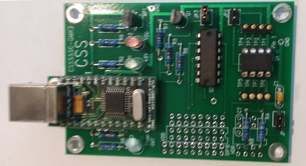

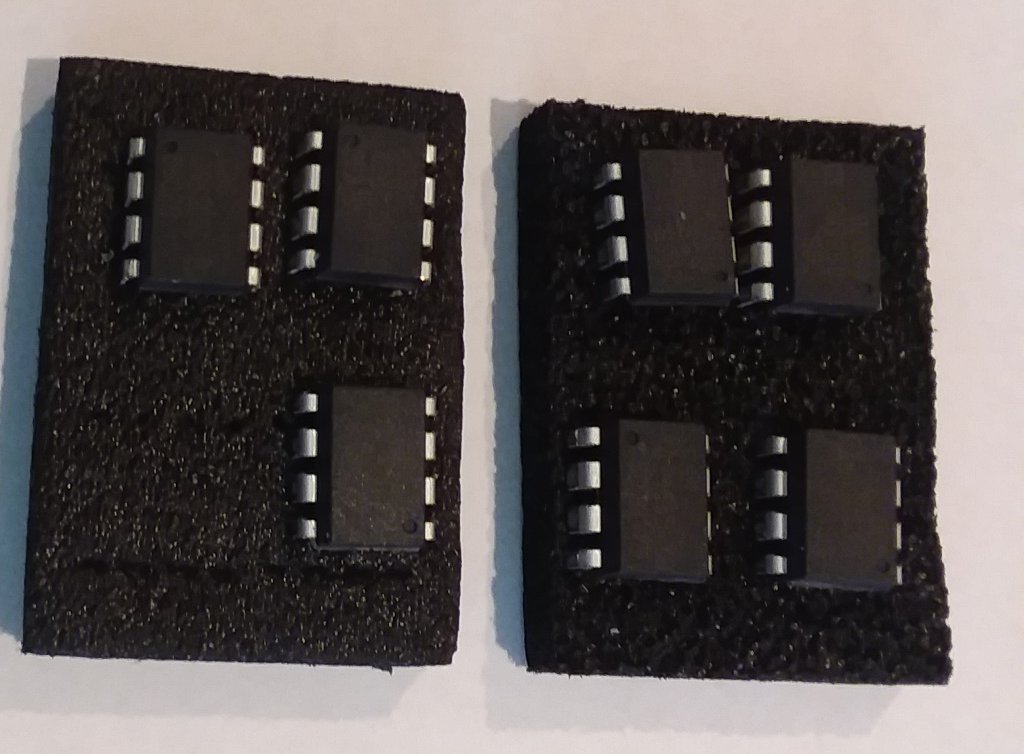

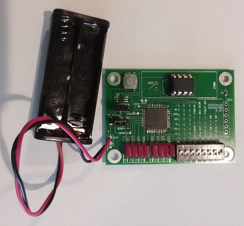

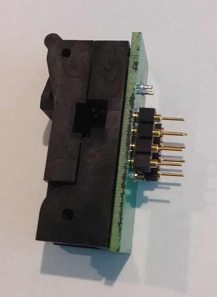

MANUAL PROGRAMMER.jpg CS555 &CS555C.jpg DIP TO SOIC.jpg COMPUTER PROGRAMER.jpg PAMPLET.jpg CS555 CD.jpg This is a kit that allows the programing of some custom made 555 timers. The kit includes a manual programmer (PN CS555-EZP) This programmer uses 2 AAA batteries for power and has a dip switch for programming. & A computer programmer (CS555C-DMK). This programmer uses a USB cable to the computer. The system also has an adapter to program 8 pin SOIC packages, a CD disk and 4 ea 8 pin DIP CS555 chips and 3ea 8 pin DIP CS555C(CMOS version) and some instruction pamplets.
Some of the features of this CS555 timer are:
Operating mode-Asable or Monostable
Power Setting-Micro-power or Low-Power
Trip Levels- Standard(1/3&2/3) or Low Voltage (10%&90%)
It also has a built in divider-1,10,100,1k,10k,100k or 1M
It is also possible to change built in capacitor value in small amounts.
