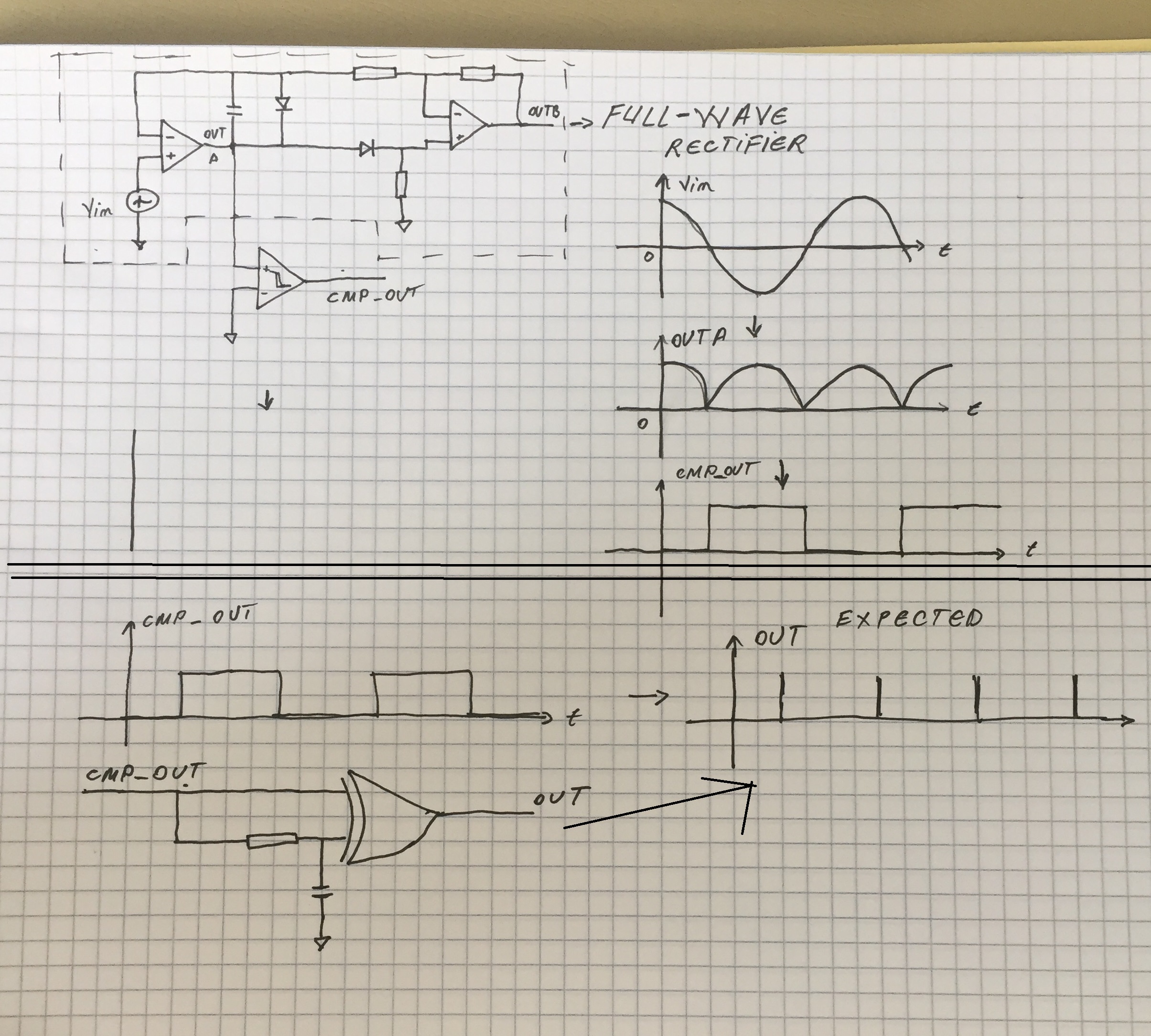

I try to make an edge triggered circuit and i am at the beginning of electronic so i need your help.
My signal is a OUT Signal from an comparator, so it'a kind of sqare wave. I have to obtain an signal like in the picture but i have to use 555.

1) Is "B" going to be a fixed frequency that you know in advance? (I assume answer is "no.")
2) Can you use active components in addition to the 555?

I know is's confusing, i don't speak english very good, i'm sory.
It's a home project, and yes i tried to google, i mounted many schematics i found and i thought could work but it didn't.
In the photo i make you can see i am using two op amps to rectify the input signal, next i am using a comparator to know where Vin cross zero.
My problem is how to do a 555 monostable for rising and falling edge detector, with an output signal like in the OUT Expected signal i draw.

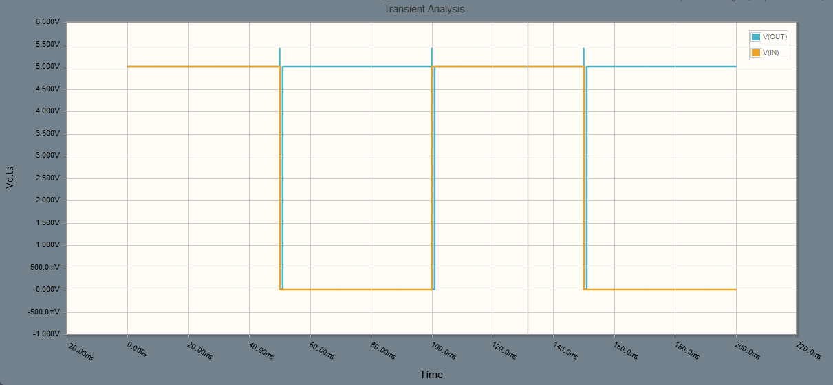

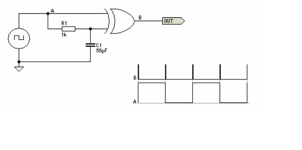

Your "out" signal is a square-wave.
That can be generated by using the signal from the XOR gate to clock a flip-flop.

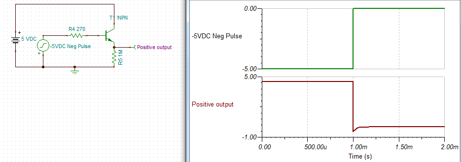

Using the Circuit Lab example, it produced this graph:
Note that VOUT is a negative pulse (with a little bit of overshoot). To change that to a positive pulse, add an NPN emitter follower circuit to the output.
An emitter follower is not an inverter. Use a common emitter transistor instead.

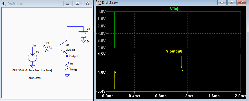

Beg to differ,
You are putting a negative pulse into the base of a NPN transistor which reverse biases the base-emitter junction and keeps the transistor off.
Don't know what transistor model you are using but you do not get the output you show with a normal transistor model (below).
A good example of blindly accepting a simulation result that makes no sense.
cowboybob
Your voltage source on the transistor base is 'upside down', which is causing the inversion you show.
What happens in LT spice if the positive terminal of the Voltage generator source is connected to ground and the negative feeds the signal to the base?
That is how a magnatron power source would be connected.
In that case, Vo is the opposite of Vi source or one could say it inverts the source.

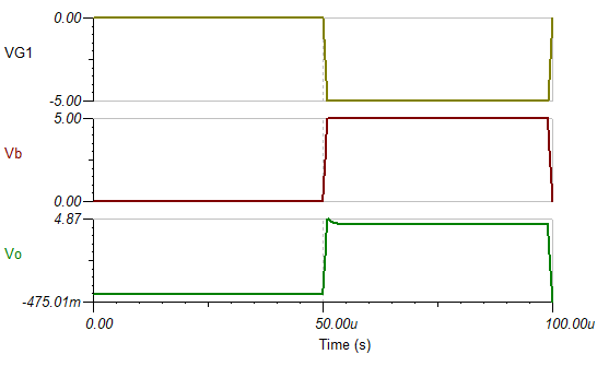

It's not blindly following what the simulator says. The signal is still positive at the base of the transistor with respect to ground.
Vo is inverted with respect to the voltage generator.
Thanks, Joe.
That's how I wired the negative sig source and, as you saw, how the SIM (TI TINA) responded. Intuitively it should not have worked, but it's what the circuit produced.
I should have bread-boarded the circuit, but I've come to trust my SIM after beau-coup proofs with actual circuits. The only exception I can recall is the 555 latch circuit that the SIM allowed to work consistently without a cap on the Reset pin.
When the heavy hitters came at me, I caved...
