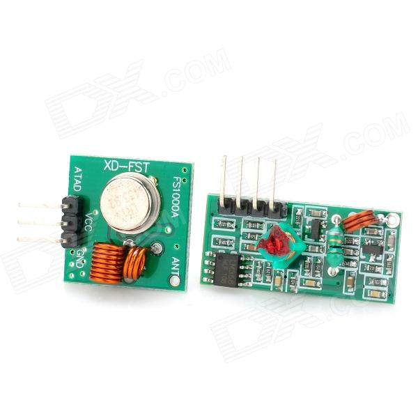

    hello i want to build a simple remote light controller
    i have two pic16f88 and i bought a 433mhz rf/tx module can anyone help me with the code because i dont know how to use rx/tx?
    im using mickro c, and i want just to turn a light on and off by pressing a button
    thank you very much!

    this is my module,
    im going to build the board is not like the item you used

    Here is what you need to know, complete with sample Pic code.
    There is a lot of data and code out there about using these modules with Arduinos...
