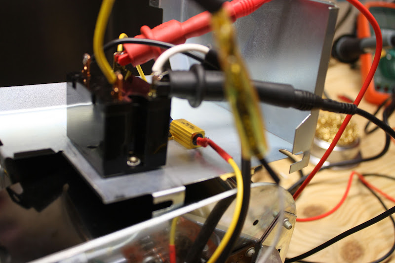

Okie dookie... life got in the way, but I'm back at it. I got my hands on a 12 amp bulb. Here's what I'm finding:
- The "new" bulb is a little longer, and is rated for 115v AC. Here is the datasheet.
- The "old" bulb is rated for 280v AC. I pulled a voltage reading across the lamp, and it looks like it's running just under 300v AC when engaged. Here is the datasheet.
So, here's the rub - how can I convert this to run on line voltage instead of the post-transformer 300vac, but only engage when it's supposed to?
I would kill a man for the wiring diagram of this thing. Any suggestions on where to look for a schematic would be much appreciated.
Thanks in advance for any help!
Mike
If I understand you correctly, the original lamp is powered by the secondary winding of a transformer, that currently "engages" as required. The original lamp is rated at 280v a.c. You wish to then swap it for a lamp rated at 120v a.c
I am assuming a couple of things here, but you should check to be certain:
The lamp physically fits the space and lamp holder and has adequate cooling
Nothing else apart from the lamp is being powered directly from the transformer and not through a relay or contactor and the transformer primary winding voltage is 120v a.c
If those conditions are met, you should be able to simply remove the transformer and wire the lamp to the existing wiring currently going to the primary side of the transformer. If some or all of these conditions are not met, you will have to investigate/ modify as appropriate first. For example, a motor, as well as the lamp is powered from the transformer, then simply leave the transformer in and connected to the motor but move the wiring for the lamp to the primary 120v a.c side :)
Some good quality photos may help get some answers if there is any doubt over how it may be wired :)
Incidentally, the links for the lamps that you posted, peg both lamps at 1350W, so the replacement lamp, being that it is rated at 120v a.c as opposed to 280v a.c will be wanting to draw approximately twice the current. So make sure that the wiring to the transformer is capable of handling 12A plus :)
I assume that the lamp is either on or off, and that there is no cunning power control for the lamp.
You need to find out if whatever device switches the 280 V lamp on and off is in the 280 V circuit. It could be that the 280 V circuit is switched, or it could be that the 120 V circuit is switched, so that the transformer is turned on and off when the lamp is required.
If the 280 V circuit is switched, or the 280 V from the transformer goes anywhere else other than the lamp, it would be best to keep the transformer. You shouldn't use the 280 V switching device on 120 V because the current will be more than twice as much. I would suggest using a relay. 280 V or 300 V relays will be hard to find, but a 240 V relay with a resistor in series with the coil will be fine. The contacts of the relay would be used to switch the 120 V to the lamp.
If you do use a relay, tell us the specification and we can work out what resistor is needed.

Diver300 - this seems like a great solution. I have really no experience with relays, but I understand their function in principle. If I understand you correctly, I would wire the relay to the 300v secondary on the transformer, with a resistor in series (value dependent on the voltage rating of the relay used). I would then wire the contacts of the relay to the 120v line voltage and to the bulb. Anytime the 300v hits the relay, it switches the line voltage which turns the lamp on. Am I getting this?
You have it basically correct. The relay coil should be wired to where the 280 V lamp is wired. That might be directly across the secondary of the transformer, but there might be a switching device in the way.
The resistor value depends on the coil current as well as its voltage. You might need to do some trial or error with that. The good news is that as long as you have a suitable power rating for the resistor, if its value is too big, the relay just won't operate. If the resistor value is too low, you will get too much voltage on the relay, but a 240 V relay will survive 300 V for a minute or more, so if you have a voltmeter across the relay before you turn on, you can check the voltage in time to turn off, and you can go any buy a larger resistor.

Would something like this SPDT work for the relay? The coil voltage is 240vac, and the switching voltage is 277vac max. They're not exactly giving them away, but it sounds like this is what I'd need.

The relay should be fine. You've got the contact part of the relay correct.
The coil, with its series resistor, should be wired to where the 300 V lamp was connected. In other words, the one side of the relay coil should go to one connection that used to feed the 300 V lamp. One side of the resistor should go to the other connection that used to feed the 300 V lamp, and the other sides of the relay coil and the resistor should be connected to each other and nothing else. (You have shown that)
We don't know, and there is no need to find out, if the 300 V circuit is connected to the 120 V supply. Therefore you should not have any common connections between the contact side of the relay and the coil side of the relay. Your circuit has the contact "A" wired to one side of the coil, which may be wrong. It is safest and easiest to keep the two sides separate.
With that relay, you need a 15 kΩ resistor, rated at 3 W or more. You need to buy a resistor that is rated for 300 V ac. It will have to dissipate between 1 and 2 W. Power resistors run really hot at their full rating, so a larger power rating keeps things cooler. I suggest something like

The relay voltage that you will get with 15 kΩ is likely to be between 180 and 250 V, and the power in the resistor between 1 and 2 W. The uncertainty is because the relay data sheet doesn't quote the coil inductance and resistance separately. The inductance and resistance combine to create the impedance. The impedance can be calculated from the fact that the relay takes 10.8 mA at 240 V, but the effect of adding a series resistance is not known exactly without knowing the inductance or resistance. It would be a very good idea to check the voltage across the coil when you have connected up. It should be in the range 180 - 250 V, which should be within the acceptable range for the relay, but if it isn't, tell us the voltage (and measure the 300 V supply under the same conditions) and a more accurate resistor value can be worked out.

SUCCESS!!!! Thanks to all for your help (especially Diver300) - this solution works GREAT. The coil of the relay has just over 200v across it when engaged, and the bulb works as designed. Holy cow is it bright/hot when running it without the baffle in place.
The relay and resistor fit really nicely under an existing cowl (shown detached in photos below).

Thanks for telling us that it works, and the photos.
Now I've seen how big the relay is, and the fact that you've screwed it and the resistor down, it confirms that the resistor was the right choice, even if it you might have saved a dollar or two on a smaller one.
