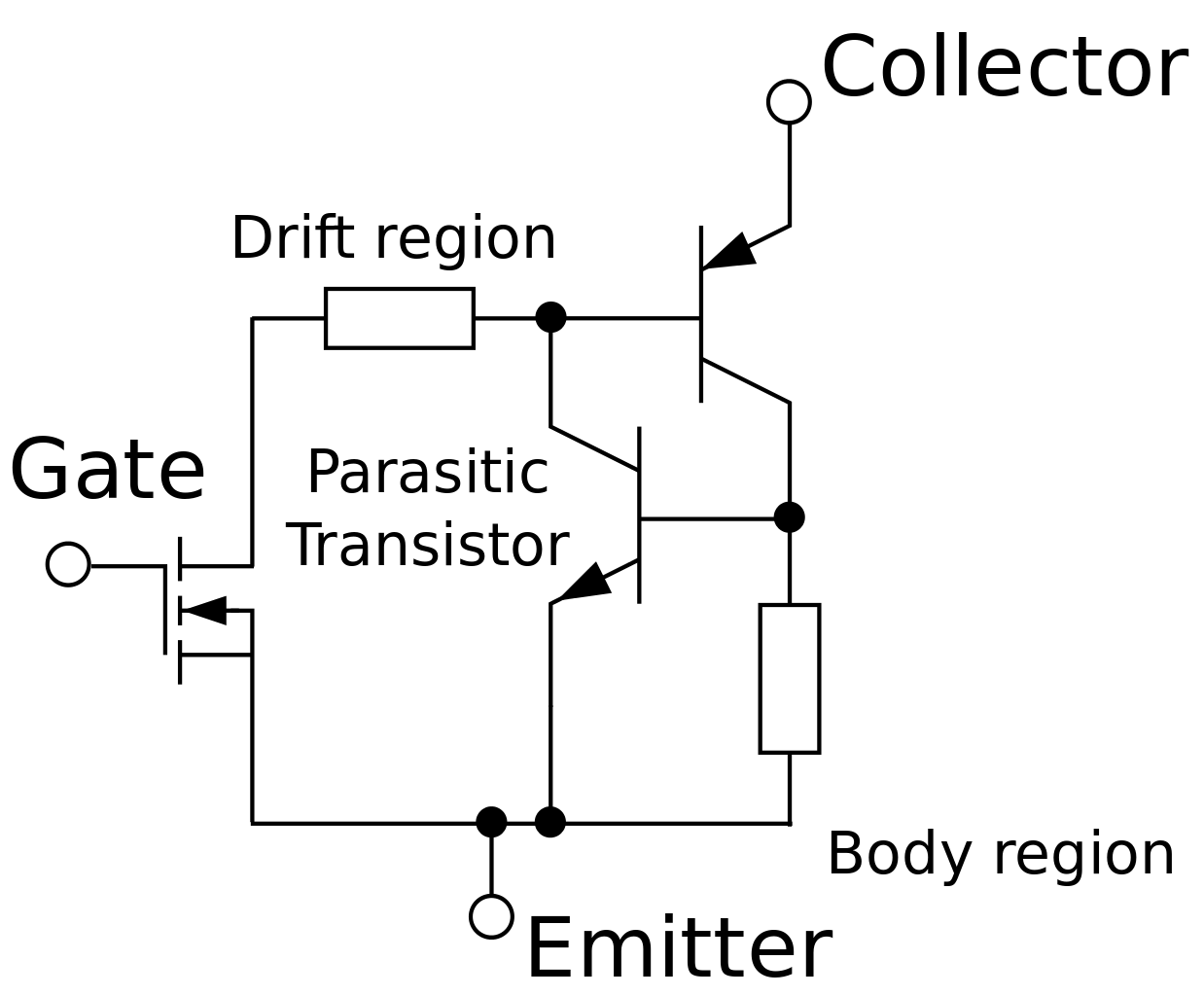

Does the 1GBT operate the same as a Mosfet?
I took an existing mosfet circuit and put the 1GBT in the circuit, will this work?
Before I go to the trouble of doing the math I need to make sure this circuit will work. I am going to use water cooled 1/2" copper tubing as wire. The circuit will be self contained in a case with no power supply transformer. My 225 amp Lincoln stick welder will be the power supply transformer. Pump, radiator and cooling fans will keep the induction heater circuit cool. I have 600 amp 600 volt diodes to convert welder AC to DC. I also have 800A 600V diodes but dont think they are needed.
When I need to use the induction heater I will clamp the welder cables to the terminals on the back side of the induction heater then set the amp load on the welder with the selector switch.
I am not sure the 1N5819 diodes are correct for this 1GBT circuit?
I also need to determine the corrent resistor value for the gate circuit?
I need to calculate the correct choke uh and experement building a large choke coil that will work?
I may need to put the power supply capacitors and rectifiers in a seperate case with cooling the capacitors will take up a lot of space.
I want this circuit to be bullet proof. All the parts need to be over kill and cooled. Induction coils will attaching to the front of the unit with brass and copper tubing fittings. I have some high power water cooled resistors 1 ohm and 10 ohms I'm not sure if I can use these. The cooling system will be filled with transformer oil.
What is gate current on this 1BGT ?

Because 1N5819 are already in this mickey mouse circuit. 1GBT replace the Mosfets, already said that above. Diodes probably need to be replaced or 20 diodes put in parallel for 20 amps. I dont know gate amps yet.
My welder is 65 volts AC. Amps will probably never been 200 but never know until I test it to see if it will do what needs to be done that is what the selector does on the welder. I need to heat 2"and 5" diameter pipe red hot. Assume max load is 65 volts, 100 amps = 92 VDC at 100 amps = 9200 watts. 200 amps would te 18KW and 225 amps will be almost 21KW.
I finally found a data sheet that is not trash advertisements. Max gate voltate 20. Threshold 4.5/6/7.5. If I am reading this correctly cutoff current is only 2ma?
The circuit needs to be changed. The gates need their own power supply voltage.

Do you mean IGBT (not 1GBT)? IGBT stands for Insulated Gate Bipolar Transistor.
To answer your question (well, not really, but partially), an IGBT is effectively a MOSFET switching a bipolar transistor. When looking from the gate it resembles a MOSFET, but when looking from the collector/emitter, it looks like a BJT.
I notice your circuit is asymmetrical. Is that intentional?

The data sheet says gate is 7.5v 2ma. Does this mean the internal resistance of the 1GBT limits current to 2ma or does the gate resistor do that? I'm not sure I know how to calculate the correct value of the gate resistor.
The gate charge is 3000nC or 3 uC. The switching overheads are about 450ns. The suggested Gate resistor appears to be 2.1 ohms. I generally use 4.7 Ω or more to limit ringing also a ferrite bead close to the gate will help.
If your gate drive can deliver say 3A then you can charge the gate in about 3uS ( as 1 C=1A*1S). Add in switching overheads and you can see you will switch on or off in about 4uS. Increase the gate current for faster charging. To achieve higher gate currents with the gate resistor you should drive the Vge to perhaps 18V for cleaner switching.
PS: Use a gate drive that can source AND sink. Just sourcing and relying on a resistor to sink will slow your switching and leave the collector-emitter in an active region and cause excessive heating.
The 7.5V spec is for the maximum emitter-gate turn on threshold. That means that it might not turn on at all with a voltage less than that. I would suggest a minimum voltage of 15.
But you're going to have a big problem with the passive gate drive circuit you are using. The gate capacitance, Ciss, for that IGBT is 120nF, which is huge, and will run Very Slow with a passive gate driver.
If you want to use IGBT's, you really need to use a real PWM controller and some high current gate drivers.
