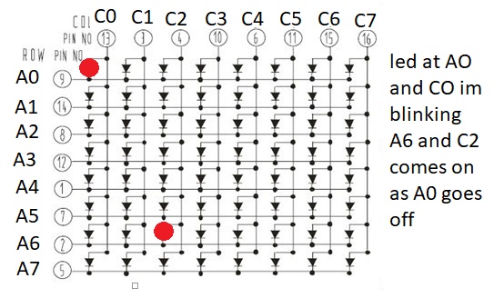

Trying to figure what I'm missing swordfish set's pins to digital but when I blank the 8 x8 leds there all off
I blink A0 C0 led and A6 C2 toggles with it.
Do they come on together as you say in the post or one after the other as you say in the diagram.

Ian it's hooked up as in the pic col to portc with 1 k resistors and rows to porta to sink

I agree with Ian... bit operations on the LATx shouldn't cause RMW problems, and the Swordfish 'high(PORTx)' and 'low(PORTx)' statements actually use the LAT register automatically for you. The slew rate control setting should only cause issues with the PORT register.
Maybe there's another PORT statement in there somewhere causing the problem?
It would have to be on the right-hand side of an expression since Swordfish will read from the PORT and do all the writes to the LAT register.

They're there to make sure the pin is an output.
I No that but it's doing it more then once don't see why because I toggle the bit it doing it over I'ts not like that if I change chips
I sim the chip with
Oshonsoft and it's showing the pins as input and set to VDD
But if I do a port write it sets them right. I guess i got some crazy 18f25k22 I like to never figure out how to set the osc has to be something left out of my setalldegital module

I sim the chip with Oshonsoft and it's showing the pins as input and set to VDD. But if I do a port write it sets them right.
SetAllDigital() just sets the analog/digital mode of the ports. It doesn't make them outputs.
You have to do that yourself for each one of the pins using one of the pin commands (output, high, low, toggle) or use the TRISx register directly.

Whats even worst is the 8x8 led I got 2 of these to play with maybe I should of got more it's bad I tried the second one and it worked fine. Pin 4 has something backward on the 8 x 8
Arrgghh!!
Blinkered by software!!
If I set pin 4 low and toggle the A0 pin
It lights the 2 leds guess the 8x8 has two backward leds
