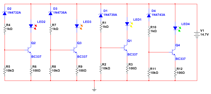

Hey guys, i wanted to make a 12v battery level indicator without using an I.C or transistors, so i got the above circuit off the internet and made a few changes to it, but somehow it doesn't work properly; all the LED's are suppose to turn on when the battery voltage reaches 12v, but only three(LED3, LED2, LED4) turn on at this voltage and at 4v led3 is suppose to be the only led on but it stays off. Can someone tell me what's wrong with the circuit. D1, D2, D3, D4 are 3.3v, 6.2v, 9.1v and 11v zener diodes.

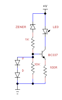

LED3 didn't come back on because it was burnt by the high current through it. You need a switch and a current source for each LED like this circuit.

The forward voltage drop across the LEDs will be at least 2 volts. If you add that to the 11 volt drop across zener diode D4, you get 13 volts. And depending on what type of LED you're using, the voltage drop could be even higher, preventing it from lighting up until you're above 14 volts.

If you want even a lower standby power draw, the circuit of post 9 with a "push-to-test" NO momentary switch.
