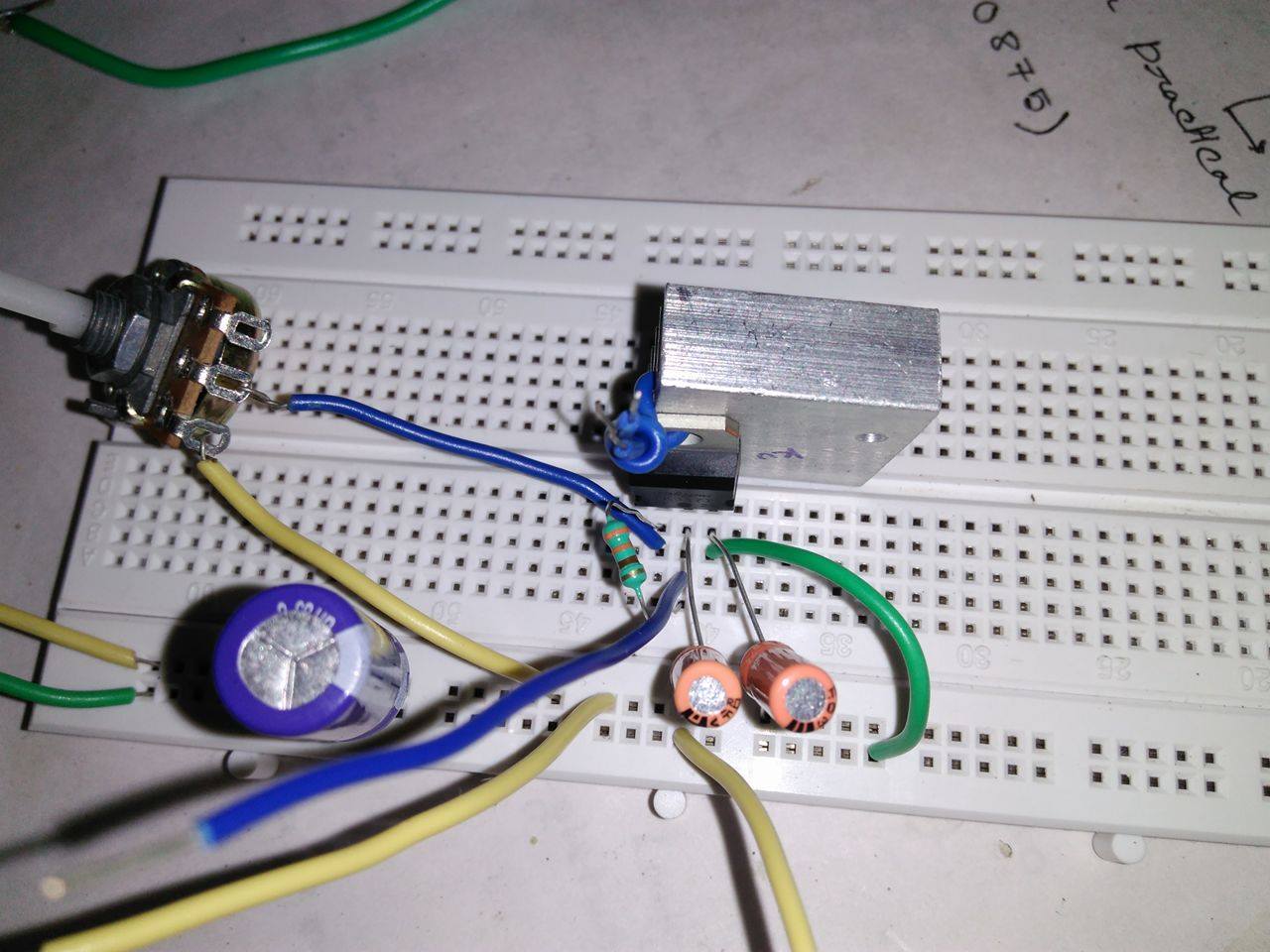

1.2 to 12 v adjustable voltage regulator (5k pot is burning)
in 1500 to 5000 ohm the output voltage is 16.50v
How can the output be 16.5V when you showed the input is only 12V?
Did you buy a fake LM317 IC from ebay?
An LM317 needs a 120 ohm resistor from its output to its ADJ pin. A more expensive LM117 uses a 240 ohm resistor. If the resistor value is too high then the output voltage of some LM317 ICs goes higher than it should when there is no load.
The pins on an LM317 are 123 when you look at the epoxy with the part number printed on it, not when looking at the metal back.

The LM317 may be oscillating which may give an output voltage higher than the input voltage as seen on a digital multimeter.
Correct AG. I was looking at the original National LM317 data sheet which shows a minimum load current of 5mA. The latest Texas Instruments (bought National) data sheet shows 10mA as you say. https://www.ti.com/lit/ds/symlink/lm317.pdf

Almost every schematic in National Semi's datasheet of the LM117/LM317 shows the more expensive LM117 with its 240 ohm resistor. I wonder why this guy is trying to use 330 ohms with his LM317?
The potentiometer is not really suitable if it is designed for small signal audio type work. Taking the data sheet for a similar Bourns 5K Ohm potentiometer: https://www.mouser.com/ds/2/54/DB18-777896.pdf.
The max power dissipation = 200mW or 100mW depending on law. For a 5K potentiometer this corresponds to a maximum current of 6.3mA and 4.47mA respectively.
spec
The 5k pot is used with an LM117 and a 240 ohm resistor to produce a maximum output of only 27.3V. When the resistor is 120 ohms and the pot is 5k ohms then the output of an LM317 will try to be 53.3V which is much too high.
Here he is using an input of 18VDC and might want a maximum output of 16V so when the resistor is 120 ohms then the pot should be 1.5k and it will not get too hot (15mW).

yes this input is output of a rectifier and i think after filtering it ,it gives the peak value rather than rms
i have purchased a new high price lm317 and a 5k pot .. now i am getting perfect results with 330 ohm value of r1 ..
