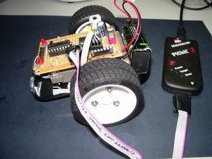

Bottom view. Only 2 LEDs and 2 LDRs are used. The chassis was from an old PC mouse.
Top view. Motors, gear box and chassis.
Main PCB and electronics components. Major components are P16F684 and L293D. That's why it's called Simple Line Follower. Speed, sensitivity and differential motors drive can be software adjusted.
Programming/ development stage.
Final product.
Please see it in action:
http://au.youtube.com/watch?v=8Z_MmrdH4oc
Or
http://s271.photobucket.com/albums/j...nt=Testrun.flv
It still needs improvement. I want it to go faster especially going around curves. I also want to run it on a more difficult track.

Looks great, nice use of an old mouse too. To go faster you could change the gear ratio with the dual gearbox. What sensors did you use for the line followers?

Looks like an LDR/LED combo to me.

The sensors are just ordinary LDR. The two transmitter LEDs are high intensity LED. They draw about the same current as the ordinary LED but are a lot brighter. I also use ADC to adjust motor speed. The more light received from the LDR the slower the corresponding motor speed.
The gear ratio I'm using now is 38.2:1, which is the second lowest gear ratio. I did try the lowest ratio but it's actually slower when the wheels touch the floor. I think it's because the wheels are bit too big and thick ( but look nice ), which put on too much load on the small motors. So when the gear was on lowest ratio, the wheels spin faster before they touch the floor. But as soon as they touch the floor, they slow right down.

You've got your ratio terminology confused, it's the second highest gear ratio.
