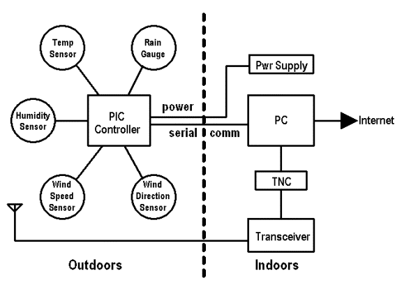

    Maybe I choose PIC controller though I'm not really specialist, but I have programmed controllers few times in school.And what I'm doing is something like this http://www.njqrp.org/digitalhomebrew...wx/pic-wx1.gif

    Yes but I would not choose to use the 16F84. As mentioned many times here it is obsolete and expensive.
