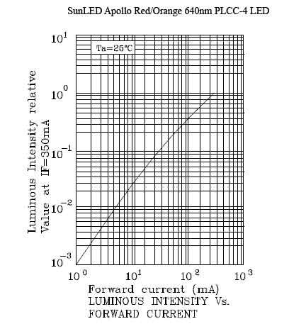

What kind of Power Mosfet can you use? I tried a circuit similar to that with a Tip31?
http://www.electro-tech-online.com/e...chematics.html
I am in another thread, asking basically the same question, I'll repost it here how I am approaching it with limited success... Please feel free to ignore, but I didn't want people to have to repeat themselves, or if someone else missed this thread like I did... :-/
Ok, I have tried this circuit, and it doesn't quite work as expected... Basically I have 8x 350mA capable LEDs 2 sets in parallel of 4 in series... I THINK... I am not sure exactly the load... But I'm trying to get 2 sets of brightnesses for my tail lights. And they're not exactly working how I expected.
First pic is the full brightness, it should be 640mA by the calculation of the lm317 which I am using, which is R = v/A so 1.2/.64 = 1.875 = ~1.9hm:
If each LED can take 320mA I think 640mA is correct, but I'm not sure if how I wired them is really 2 parallel strings of 4 in series. This is just the way I had to mount them based on my thermal and space contraints... pics to follow of my rationale.
Am I really getting 320mA to each LED? I'm a bit confused on the parallel, but I think I am?
Second I intended to run them at 2 different brightnesses, basically 320mA and ADD another 320mA diode isolated of course... but just adding two constant current sources together to get 640mA. It doesn't really work that way, it gets barely if any brighter. This is how I had that wired:
Now I was thinking it was possible that the two chips were not functioning properly, crossing each other out or something, so I tried just 1 LM317 with two 3.9hm: resistors in parallel to get my 1.9hm: but connecting and disconnecting that 2nd 3.9hm: resistor which SHOULD have netted me 1.9 ohms just didn't do anything at all... so I'm confused. I thought you can parallel resistors to get R1+R2/2 ?
Since I didn't get "half" of the brightness, I Thought maybe it was a non-linear brightness for power, but according to the SunLED Apollo PDF, this chart shows that I really should be getting about 1/2 the brightness for half the current through these LEDs...
So what am I doing wrong? Thanks for all the help. Bill

55watts of LEDs is REALLY REALLY REALLY bright and/or heat. I have 8, ~3/4watt each LEDs and I have a CPU heatsink w/fan running on it. Remember LEDs aren't that efficient. So thermal management is going to be your biggest challenge, not the dual brightness...
Here's a nice little chart I found:
Even the Lumiled K2s are only 40-50 lumens per watt... and to equal a 55watt regular halogen Foglight (I assume that is where you got your 55watt number) you would be at 1375 lumens / 40 lumens/watt LED = 34 watts of High power LED...
at minimum with the impossible to mount SunLED Apollo PLCC-4 LEDs, you are going to be looking at a chunk of aluminum like 12" x 12" plus at 3$ a pop, 102$ for JUST the LEDs... If you went with the K2 which are electrically isolated, hence easy to mount on a heatsink, you are looking at 9$ a pop... x 34 = wayyyyy too $$$$ I think.
