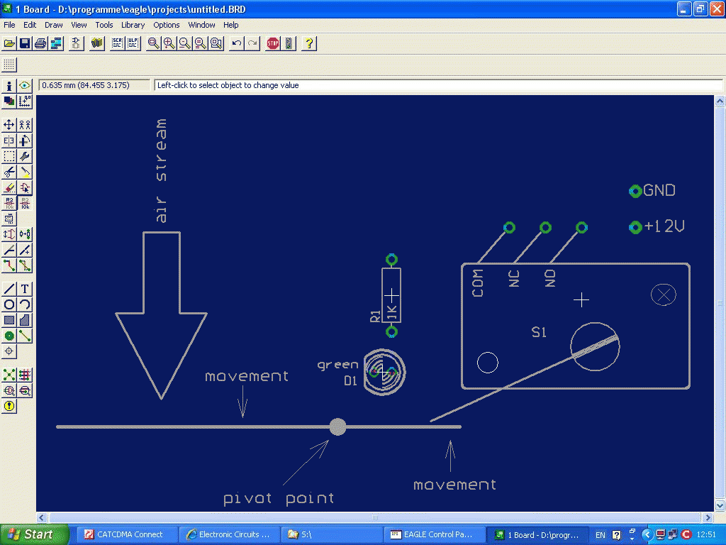

    hi ya'all,
    i want to design a circuit which will tell me in real-time what is the status of the radiator fan in my car (alive or dead).
    i thought of placing a led in parallel to the fan but the problem with that is that the fan could be actually burned out while the led will still be on (it will still recieve 12v).
    any suggestions?
    mabe some kind of tachometer or any other simple sensor?

    Hi ferez,
    you can make an air flow sensor using a small plastic sheet and a microswitch salvaged from a mouse.
    Those switches are small and require little mechanical pressure to operate them. Mount the switch on a piece of plastic (PCB-material) and use a mechanical load in the air stream to move the button. As long as it is depressed you can be sure the fan is working.
    Here is a suggestion.

    Hi Hans and thanks for your idea.
    The principle of your idea is nice but there's a problem with it.
    You forgot that while the car is on the move, there's wind that comes from outside and can operate the microswitch even if the fan isn't working.

    When fan bearing/bushings fail they seize, on the units I have seen this blows the fuse.
    To detect a blown fuse you only need to detect a lack of voltage on the fused side of the circuit.
    The fans may open circuit which would cause them to fail without blowing the fuse. RODALCO's current detection using the reed relay would work to detect the lack of current through the fan. The fan should be thermostatically controlled so you need to only light the error LED if the thermostat is on and the fan is not running.
    Light RED LED when ( (FAN_ON) AND (NOT(FAN_RUNNING)) )
    which would be thermostat is on but the reed switch is not powered/active.
    Run the fan hot lead through a
    normally closed reed switch (SPDT wired to open when active).
    If the fan is on and the fan is running the led will not light.
    If the fan is on and the fan is not running the led will light.
    If the fan is off the led will not light.
    With a bit of work you can light the same LED when the fuse blows.
    It would be easier to add a second LED to indicate a good or blown fuse.
    Good fuse is easy, a green LED and current limiting resistor on the fused side of the fan prior to the thermostat. For a bad fuse you need to invert the logic and light the led when the fuse is blown, no voltage on fused side.
    I am in the process of (slowly) building a custom fan control system. I plan to have heat sensors on the engine and radiator. Since I will be switching the fan(s) I already know when they are on/off. I like your idea of using a tach even if it is overkill. It would give advance warning of bearing failure as indicated by a decrease in fan speed. But this is not a simple sensor.

    Can easily be compensated by a spring.

    Quote Originally Posted by Boncuk
    Lets say the fan flows air at 40MPH. How does a spring loaded switch know the differance between the car traveling at 40MPH with the fan off or
    the cat at rest with the fan on.

    Quote Originally Posted by 3v0
    The spring doesn't know anything, but YOU know. 40MPH equals lousy 70km/h, a speed which allows you to pick flowers on the way. Going at speeds of 240km/h and more like in Germany there would be a problem. The 40MHP equals 0.01MPs, while the fan produces 0.019MPs at least.
    As you probably know the air pressure increases with the square of air speed (and and so does the aerodynamic resistance), meaning the pressure has to be four times higher at double speed.
    This is a very distinctive difference which can be used to evaluate the fan status.
    You can make the whole thing more complicated employing a diffential pressure transducer. But that one doesn't know either when to deliver a valid "fan operating" signal unless you use it for your logical circuit.
    You can even make it one more step complicated using two pitot tubes and compare the speeds.
    It all depends on the budget.

    here is a modification of the suggested device.
    There is one big advantage to it: It's affordable and reliable.
    The function is the same as it is used in many fighter airplanes to extend the slats for better maneouvering at low speed dog fights.
    For a better construction search for "bellows"
