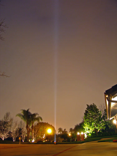

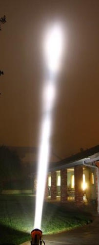

You know the spotlights that cops have on their cars? Well I wanted one :lol:
I bought a 50W halogen light from allelectronics for $2.50: http://www.allelectronics.com/cgi-bi...503&type=store
I then put it inside of a 2" piece of ABS pipe (because its black :lol: ) you can use PVC too. I also put a 2" cap on the back where I put a panel mount toggle switch and drilled a hole to put a wire through so that I can hook it up to my truck battery. I wanted to put a cigarette lighter plug on the end but I didn't have one. You can see how I held it inside the pipe, with four screws, in a square if you're looking straight on at it. Two to hold the bottom and two to hold the top. I just got to thinking that one way I could've improved the design would be to have a piece of plexiglass on the front holding it in and the two screws on the back but ah well :wink:
It's only about 6" from front to back. It works GREAT! take a look at the photos. I drove by a party and shined it at all the kids, must've gave 'em a bit of a scare :twisted:

wow that light shines a long way.

looking at the top picture one would think that this light somehow produces lot's of vibrations
